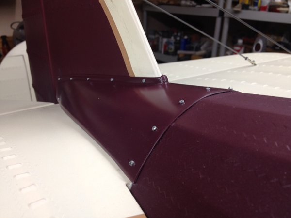

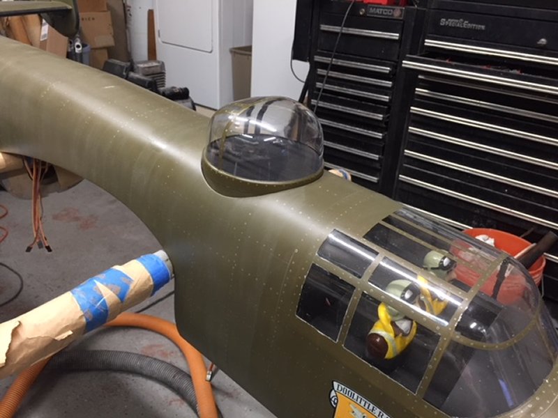

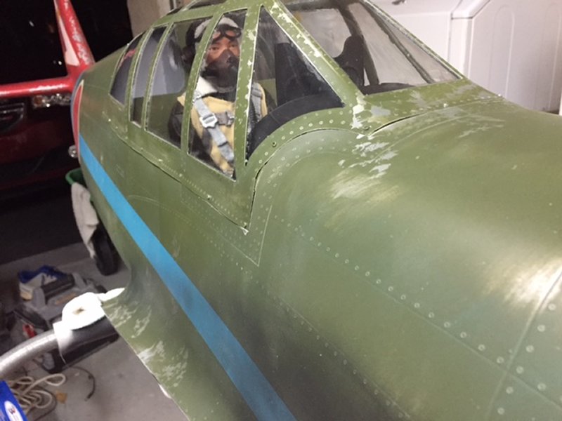

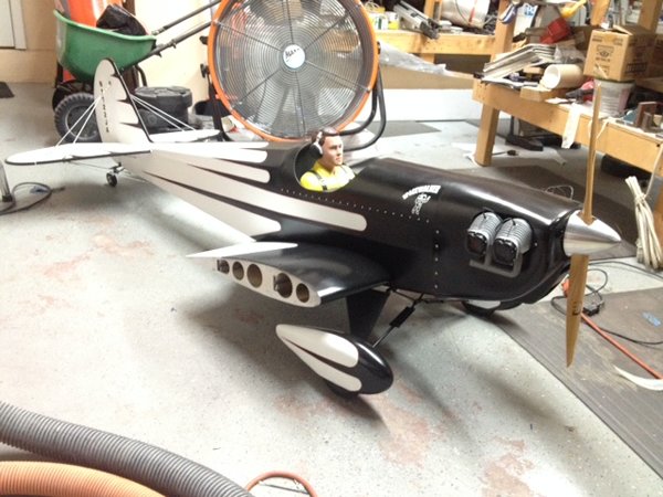

Here is my latex tutorial with pics... All I use is latex.... in general I spary flat paint only and use clear to set the gloss... but know this... you will NEVER EVER get a glossy paint with latex like you can with car paint or epoxy. Also if you try and teat it like other paints you will not be happy.... must use 3-5 light wet coats when painting.
