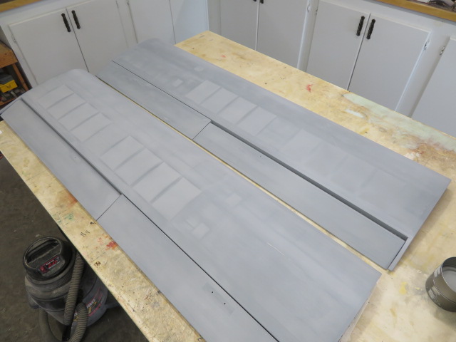

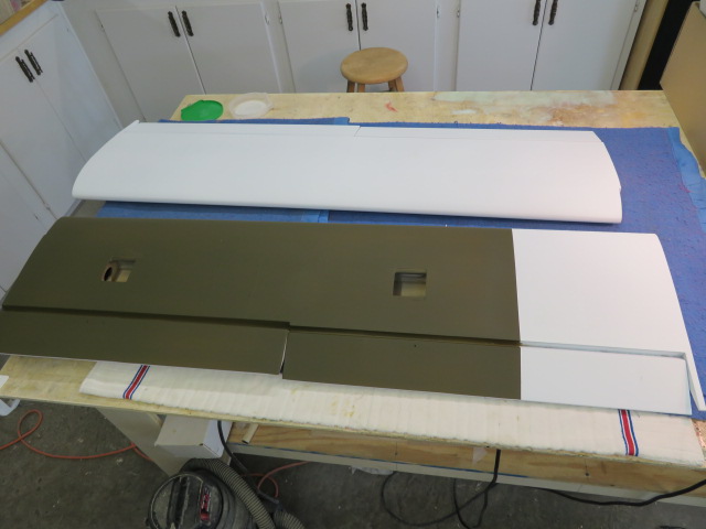

Skydiamonds, maybe this link will help. I just used Koverall on the Porter PC-6 wing build. You have to add a glue such as Sig Stix-It on the balsa and let it dry, then cut and iron the Koverall on. It's also heat shrinkable. It's really very close to Solar-Tex without the glue. It's also very close to a full scale covering after painting. I cover the whole process for one of the flaps on the link below. And you can see how it looks after painting with pics below. I think Koverall scares people off because there's no glue on it, but it's really not a big job. Sig also says on the packaging you can use Nitrate dope or epoxy resin to glue it down. The 5 yard package is 5 feet wide and 15 feet long! Lots of material for not much money. It's a little more work, but since Solar-Tex is out of business now, might be a good solution until something else takes its place.
Koverall Used on Porter Build
Primed and sanded.
Painted. Top and Bottom of wings.
