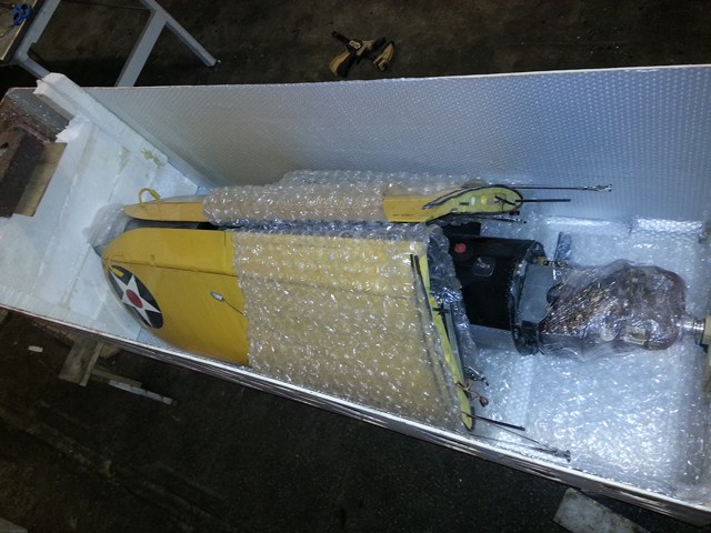

Pack it in loads of bubble wrap so it cant move.
The only strong point to fix it to the crate is the U/C. Strap the wheels down with lots of rubber bands.
Poke the crankshaft through a internal false former with a large hole. Not tight.
Fix a cut down propeller to the engine and  fix with more rubber bands.
 If you fix it rigidly,  when, not if, they drop the box it will break the firewall etc.

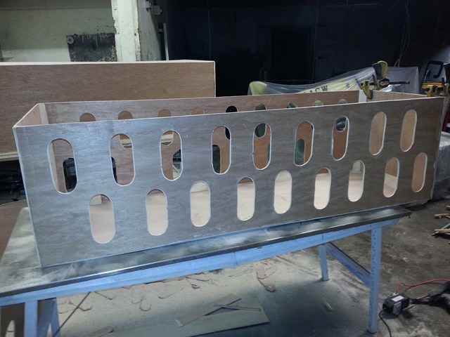

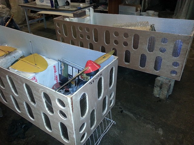

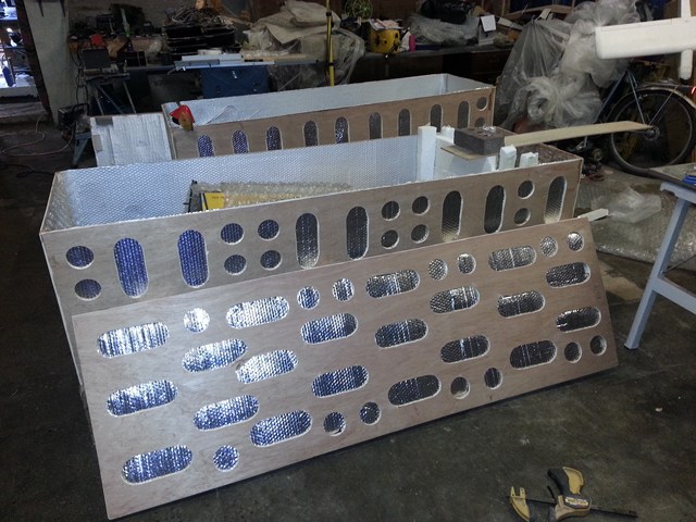

My most successfully crate is made from 1/4 light ply.
The corners and all the seems are reinforced with short balsa triangles fixed with Gorilla glue.
You can run glass fibre tape all round the external joints.
If the box exceeded weight limit drill it full of holes with a hole saw. (makes hand grips anyway)
Put some rails on the bottom in case they want to fork lift it.
Make the lid secure but removable without tools. (over centre catches)  for customs.

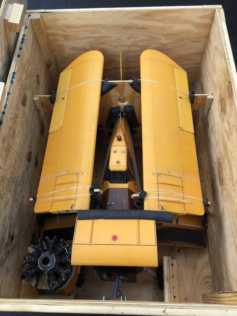

Thanks for the packing tips Richard.  I'm used to making crates for motor freight, where you're getting charged for dimensional weight anyway so the crate weight doesn't matter.  Yours are somewhat different!
I had a chance to stop by Mike Barbee's house last month and see his build.  We discussed making the tails removeable, I'm pretty sure his will be.  Mine isn't designed to be and I thought it wasn't necessary because of the F24's large struts.  But when I got home I did some looking and maybe it is necessary after all.  The stab is 36" wide but the tripod struts are only about 22.5" wide.  It's also longer than BA's luggage limit of 75" but if I take the tail, engine, and gear off it should all fit in a box about 62x24x23.
I'm planning on the batteries being removeable for a variety of reasons, but one of them is that they come with me in my carry on.
Which brings me to your tip about padding the engine.  Wouldn't it be better to remove that big weight from the airframe altogether?  It would seem to reduce the opportunity for airframe damage, it'll also shorten the box and you can carry the engine with you to save some weight from the crate.  When the Ag Cat gets crated the engine gets bolted to that vertical piece in the lower right.
