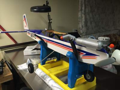

I am sure you guys are wondering what happened to this guy   Well work and other life's responsibilities took over a bit but I have been active behind the scenes--buying up plans and parts for my first scale build of the Moth Minor, I will start a new thread for the Minor.
However, this is what is going on with my wood trainer (since I need this airplane to learn to fly) ....

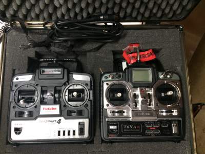

  • I have a Futaba PCM receiver in it right now, but my buddy box will not work with the PCM because it works with PPM and needs a FM receiver (which I don't have).  I had sent my radios in to Tony Stillman @ RadioSouthRC (awesome guy) and he changed the program on my master Futaba to PPM.  Problem is since this 72MHz radio is archaic and finding stuff for it is getting next to impossible (like a FM receiver)
  • The wood trainer is almost ready to go and is balanced.  All I have to do is adjust the throws and charge the battery
  • Sooooo, does anyone have any thoughts here, my objective was have this bird up in the air in August and I am not sure if I will be able to
  • Thoughts??????

I might still have a hitec receiver I would be happy to donate, the problem is finding the correct crystals to match your Tx.  And they should be HiTec crystals too.
Since they are both FM (Tx and Rx) they are compatible, unlike 2.4 which have to be from the mfgr.
If I can find it, I will PM you.
Let me know if I can help

first check to see if you can find hitec crystals to match your current frequency, or if you can find a futaba module on the same frequency as the hitec crystals you find.  You may have to search ebay, rc universe and rc groups
*** EDIT ***
Just checked - I have two Futaba FP-R127DF 7 channel FM Rx, one on 19, one on 58
I have two HiTc RCD3200 7 channel FM Rx, one on 58 and one with no crystal.
Take your pick - will be happy to send one of the Futaba or both of the Hitec.
