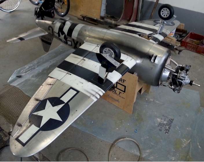

Welcome to RCSB ! You can purchase the Top Flite P-47 from Edwardo Esteves in Brazil along with its power. The Giant Scale TF P-47 is an excellent introduction to giant scale modeling. Good luck with this and your initial entry into Giant Scale modeling. Which 3D printer do you have?
If answering a question of good, better, and best P-47 design is being asked there are few comparable designs because of physical size and composition. While one would imagine a good design is of lighter weight, the older the design, there is a good chance it is going to be heavier and its bill of materials more old school than modern composite materials.
If this is a question of which P-47 provides the most scale flight performance and physical accuracy to the 1:1, I would recommend the CARF P-47 with a MOKI 250..
