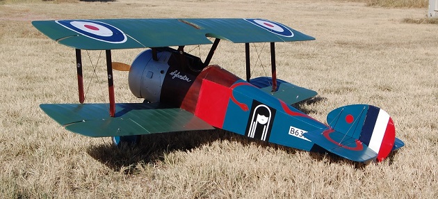

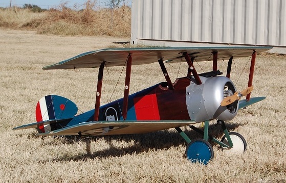

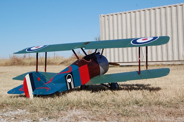

A few photos of my BSA 1/4 scale Camel. It was mostly finished back in October but didn't maiden it until last week. It started off with a converted Homelite engine but it seemed down on power. I purchased and installed a G-26. Lots more power but now the airplane needed to be re-balanced. One of the reasons I liked the Homelite conversion is that it was a convenient source of nose weight. I ended up overthinking the balancing and the Camel ended up ridiculously nose heavy. I ended up running out of elevator on the first very brief flight and put her on her nose. I removed a ton of nose weight and put in two much more satisfactory flights. The marking are from Callie Graphics and represent the airplane as it was pictured at a training depot. The aircraft had seen combat but these marking were probably applied after its return to England and were probably of short duration. the landing gear now has a spreader bar and there are a few more scale details to add such as a wind screen.
