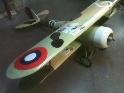

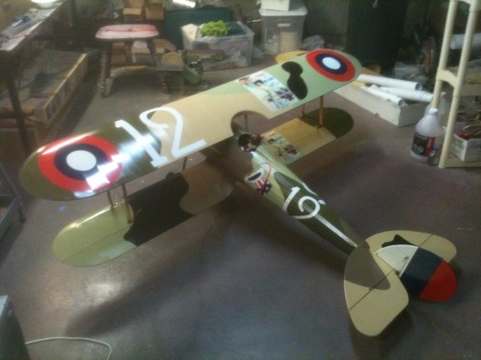

Today I finished my Nieuport 28 from a BUSA kit.  The plane weighs 15 pounds as she stands and will need a pound of lead in the nose to balance perfectly.
The plane is covered with solartex and painted with Behr flat latex with a Miniwax polyurethane top coat.  Markings from Callie Graphics.  The engine is an OPS Maxi 30 converted to gas.

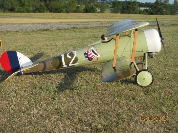

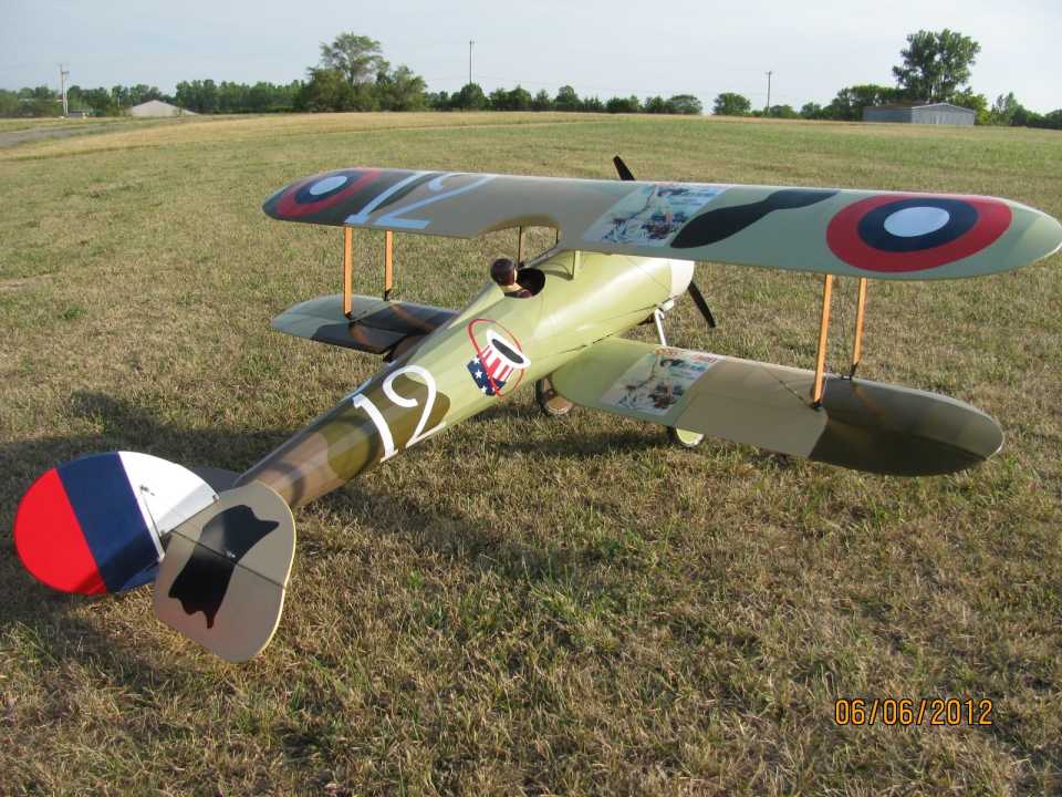

The first flight was successful but with a few squawks. I tested the engine at home this afternoon and it ran perfect.  Of course, at the field it wouldn't run at all.  After trying to get it running for an hour and getting nothing but a few pops I finally found the problem...the hall trigger sensor had backed out of the little holder.  Once that was fixed the engine started right up.
There was a 10 mph crosswind which made taxiing a little difficult.  On takeoff I couldn't go directly into the wind since that was straight toward the pits.  After a couple of swerves and zigzags the plane got up to speed and lifted off and climbed out nicely.  I found out very quickly that the CG was nowhere near the aft limit...if anything it may be a little to forward.  At least I can start taking out some of the lead weights.
The plane didn't require any trimming to speak of...maybe two clicks of up elevator.  The controls were effective but not sensitive at all.  I climbed the mandatory "3 mistakes" high and ran through some basic maneuvers...slow flight, stalls, loops, rolls, and a one turn spin.  No surprises anywhere, just a good flying plane.  The landing was also easy...a tail high wheel landing and hold the upwind wing down with aileron and steer with the rudder.
After landing I did find some issues.  The muffler was hanging by a few threads of one bolt (I thought it was sounding awfully loud!).  Also, one flying wire broke at the quick link connector.  There is probably a sharp edge where I drilled the hole for the wire.  Both easy fixes.
I'm very happy with the plane and hope to fly her for a long time to come.

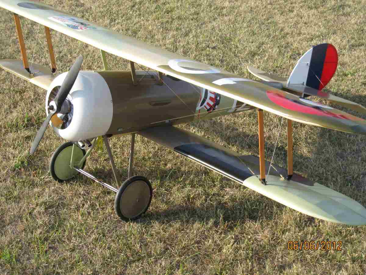

Posted: June/06/2012 at 10:16pm  Quote
More glamor shots

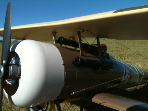

I added the guns and windshield and flew a couple more flights today.  All good.
