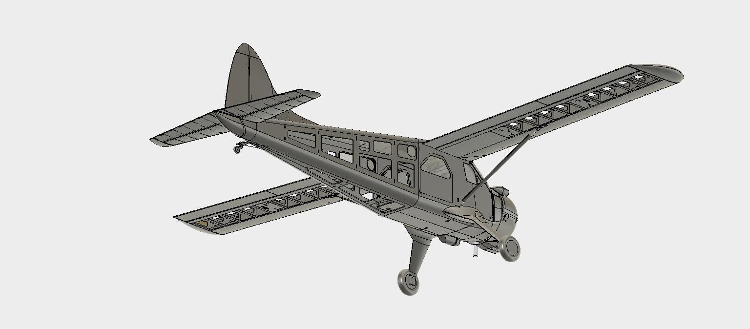

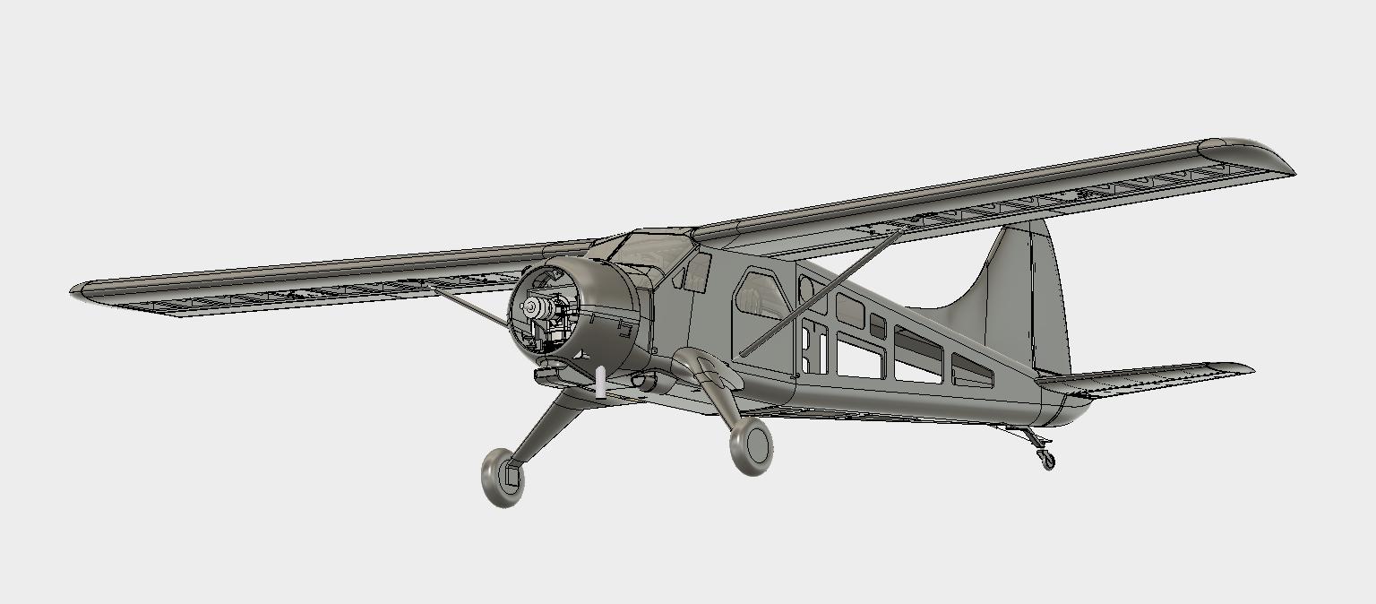

So I started with the DHC-2 Beaver at 1/6.3 scale for 20cc. It works out to a 91.4" span, which qualifies it as a giant scale airplane. 904 sq. in., 12 lbs for this first prototype. E-flite Power 60 400Kv on 6S 5000, but the next will use a DLE-20.
I worked from the original factory blueprints, so it's 100% scale. Development took a bit longer as I was learning Fusion360, my CAD program, while designing the airplane at the same time. Working in 3D is pretty involved, but it lets you guarantee the parts fit properly, especially the plastic and fiberglass parts.

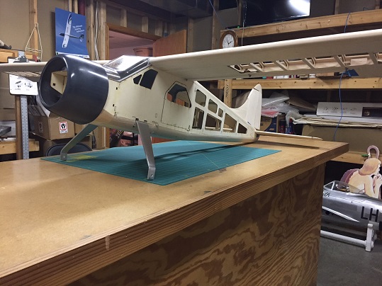

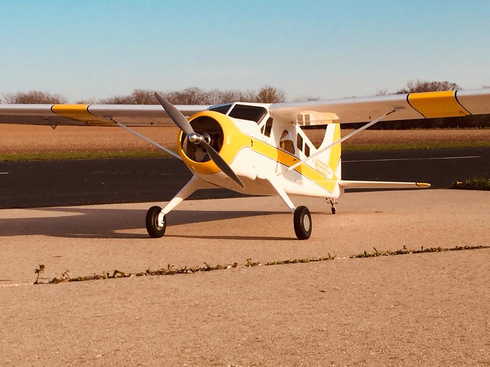

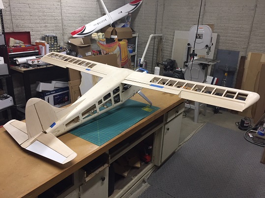

Posted: May/25/2018 at 9:56am  Quote
Here are some photos of the first prototype.

That doesn't surprise me.  I found it quirky and finicky.  Many, many times I had to walk away to avoid throwing my laptop across the room or punching the screen.  I found I couldn't create the cut files without purchasing AutoCAD LT.  Fusion's drawing environment doesn't let you edit views that you've created, which makes it impossible to create cut files or to create usable model plans (still working on that one).  The cut files I made were not able to be opened by any other CAD program but AutoCAD.
At the end of the day, though, the surface geometries worked out great for making the forms for the plastic parts and some CNC work for the fiberglass parts.  I also did some 3D printing from the Fusion model to make plugs for the wingtips and lg fairings.  I'll probably still try using Fusion360 for the next project, since hopefully things will go faster after learning so much on this first one.
