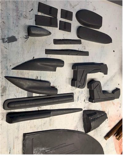

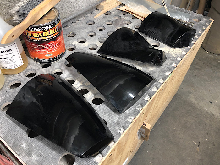

Plug has to be a high temp resin... Let me say it must be a high temp resin.
You do not want this to occur during V-forming

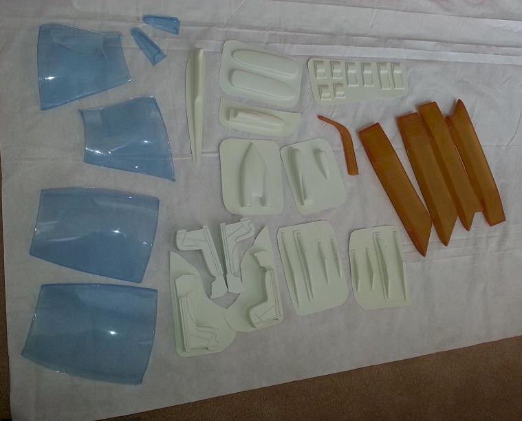

Dynamic balsa does large vac formings
You can vac HIPS over a balsa plug, finish it and then make the vac plug by pouring into the HIPS vac Durham's Water Putty, a plaster like material that is much stronger and smoother than regular plaster and which can be finished to a high gloss.  The HIPS vac should be supported to avoid distortion depending on its size
