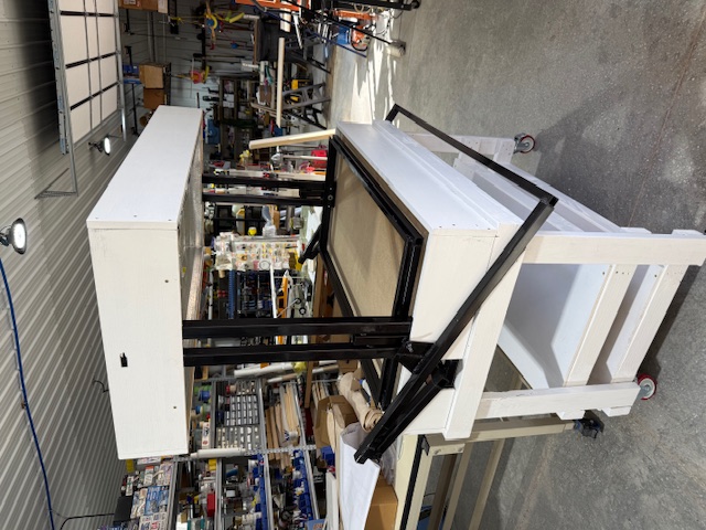

I am making good progress on the new vacuum former.  I have decided to go with a 2' x 4' table.  I have the major structure built and the heating elements installed.  Tomorrow I will embark on wiring it up.  Then I will need to plumb it.  It is a bit like building a plane in that it looks like you are close when you have the structure built but there are still a large amount of items to address to complete the build.  Anyway, onward and upward!

I just finished building and testing my new vacuum former.  The machine formed like a champ.  I need to work on my techniques is sag amount and spacing to minimize/remove webbing, but I am happy that the machine is doing its thing.  One downside is that given that the heater units were being used for the first time there was a fair bit of smoke.  That should minimize with use.
I was using some .060 polycarbonate for my test.  It worked well, but I will need to build a pre-dryer to remove moisture from the polycarb as it is very hydroscopic.  I am going to get a sheet of PETG to see if it can be used without the pre-dryer as it is supposed to be much less hydroscopic.
My former was built with 3 different platens to allow for plastic forming in the following approx sizes 1'x4', 2'x2' and 2'x4' to allow flexibility in the future.  Below you will see the 2x2 and 1x4.

Pretty serious and very nice unit.  What are you using for vacuum and the heating element.  I presume the heating thing is 220V?

Thanks Casor.  The vacuum is an Edwards unit that is using 30Gal of vacuum space to allow for a good pull.  The heating elements were purchased from Workshop Publishing for their protoform plans.  The heater is 220V with 110V to the pump and a place for aux fans.  There are 8 heating elements in the top that are setup to allow just the inner 4 to be used, or the outer 4 or both.  Below are some additional pictures.
