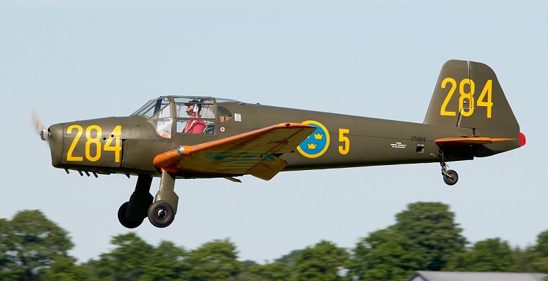

After much head scratching and looking into many possibilities, it dawn on me that nobody offers a Bü 181 in 1/4 scale and it would be a wonderful airplane to fly in civilian or military livery!
I was able to get a set of plans somewhere in the internet and planning to cut a laser cut wood kit.
At 34'9" or 10,5 m. full size  it makes a 104.25" span airplane that can fly with a 35cc engine!
A small 4 stroke twin would even be better.
Another nice feature is that it was flown by many countries and there are dozens of colorful schemes.
Looking forward to feed back or suggestions on construction features ( 1 wing, 2 wings, 3 wings, etc.)
The idea of not having to deal with retracts is also very appealing to me!
Jose G

ESM used to do an ARF years ago. It had a fiberglass fuse but it wasn't that big. It was probably more like 1/5th scale. I had one but sold it before I got around to assembling it.
This would be a cool project. I reckon a 3 piece wing would be the go. Given it has a somewhat narrow landing gear you could leave the center section attached and transport it on the mains.
Go for it

Jose, I think that the Bu. 181 Bestman is a great idea. Good looking and straightforward construction wise. My suggestions for approching the design / manufacturing are as followes:
1. Have the fuselage designed in solid modelling CAD system. Split the fuselage vertically and have a mold designed from the get go so it can be 3D printed in sections that will be pinned together for accurate alignment. I would included the fin in this mold.
2. The cowl can also be made in a 3D printed mold.
3. 3D printed plug for pulling the canopies.
4. Have the wings, horizontal tail, and rudder designed the traditional way but sheeted with flight skin.
5. It appears that the main LG was part of the fuselage. You can have it built from wood so that it can be glued permanently to the fuselage or be detachable subject to the builder's discretion. That will make the wings basically a 3 piece wing.
The above approach can shorten your time to first prototype and being production ready in a matter of 4-6 months.

Hi Jose ,good choice ,i scratch built my model a few years back ,1/4 scale ,powered by a Laser 180 , i photo my build but haven't bothered with putting it in the site ,busy with my Kingfisher, if is there enough interest i could start a build , used the full size wing section , cockpit was a pain ,all built up , will follow with interest ,, Jeff H
