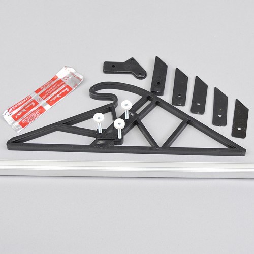

Best balsa stripper I have tried is one I bought from SLEC in the UK  few years back. It includes a 1m long aluminium U-channel that you attach to your bench or even better a piece of melamin faced chipboard. Your balsa sheet is held in position along this and that makes it easy to strip balsa and maintain a straight edge. It also is useful for checking how straight your balsa sheet is before you start stripping, many sheets do have a less than perfectly straight edge to them.
