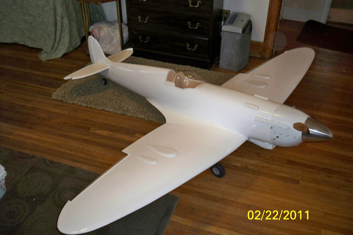

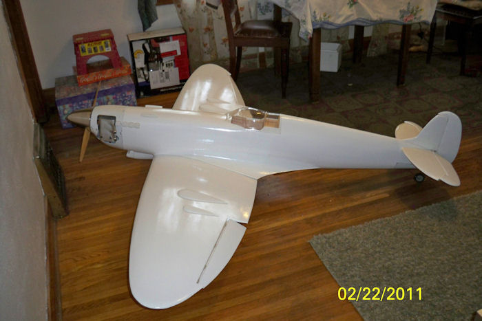

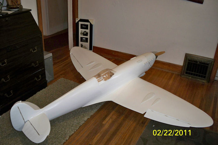

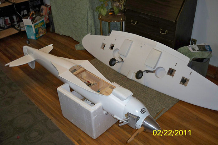

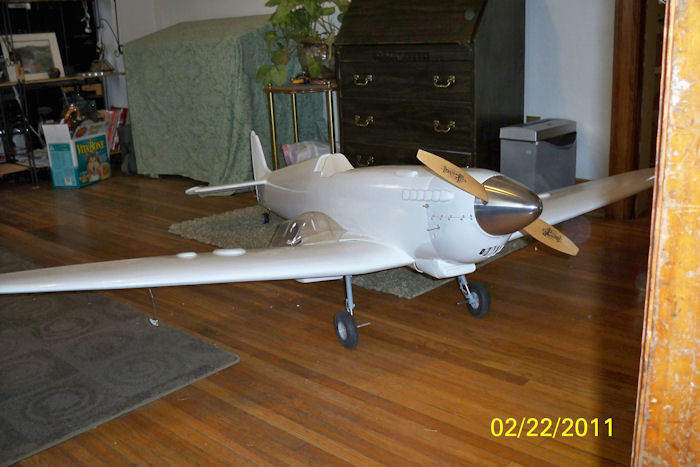

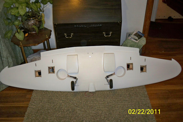

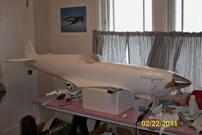

Hi David, thankyou for the warm welcome and the info regarding Yellow aircraft.  I will be heading there after I post this.  I thought I would post some pics of the Spitfire as it is right now.  It will be shelved for some time unless I can get the paint situation solved.  I am really thinking about latex with a coat of polyurethane clear (glow fuel powered) especially after what I have read here.  Unless I hear from Warbird Colors about the paint I would like to order, that may be the direction I am left with.  I am hopeful.  Do you know if they are still in business, I see WBC mentioned in many posts but they are older ones and the website said you have to email him with your info, which I did but haven't heard anything yet.
At any rate, here are some pics... it is covered in 21st Century fabric and Worldtex fabric.  I ran out of Worldtex quickly and had a 30 ft. roll of the 21st Century stuff sittin around.  I only had enough to cover the bottom of the fuse, wing and flight control surfaces with Worldtex.  The fuse has received its first coat of primer and sanded.
Hard to make out, but I made false ribs for the tail surfaces with thin strips of balsa, looks great with the fabric covering over it.  I forgot to build in the trim tabs though, so I will just be happy painting them in.
The business end of this has an O.S. 1.60 2 stroke glo engine with a pitts muffler.  This was recomended to me by a hobby shop owner as plenty of power for this kit.  I am at 16.5 lbs right now, and have not balanced the aircraft yet.  From what I have read, I may need to go to as large an engine as a 50cc gas burner.  If so.. my paint problems are pretty much solved.  But then I have and engine problem.

Chuck from WBC is absolutely in business and I have ordered several times in the past 12 months.  The best way to place an order is via the website but I  just saw that he is having website issues.  Send him an email with you order.  Chuck will take care of it for you.
