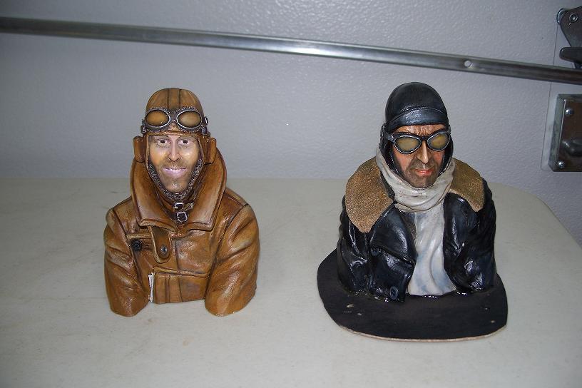

Where did you get that great pilot figure? It looks like he
really means business.

I'm sorry I missed your post until now. Yeah, she'll build back just fine. It was mostly the gear wires and fairings. It's just I was "done" with the tripe and ready to move to the next......then oops.  The pilot came from Aces of Iron. They have the best I have found, although only busts. My nephew(an art major) painted them(I have 2 others) for me. Here are two of them. I used Solartex over all of it and just painted on that with Bear exterior latex house paint. I even took a small sample of the Solartex down to the store and had them scan the color for touch-ups. I also found the new small sample sizes are great...and flat finish too! The black on the nose is sprayed, all other paint was hand brushed.
