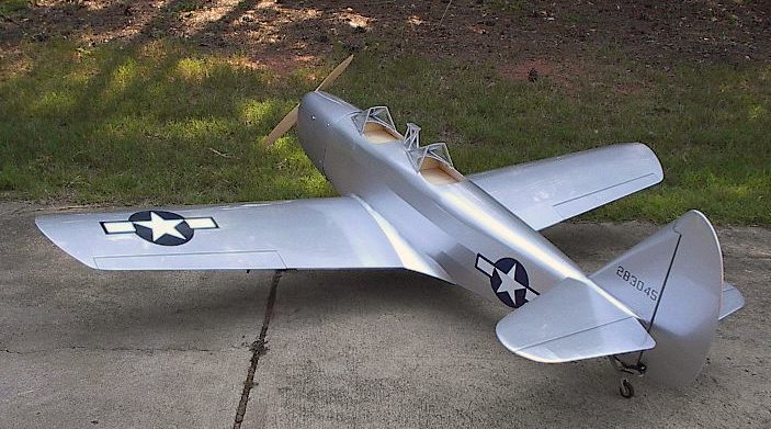

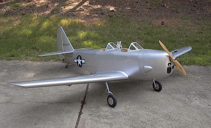

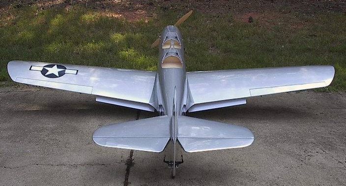

Here are some photos of the aircraft before initial flight testing:
From the initial flight I knew this airplane was going to be a long-time favorite.  It required no pitch trim changes, but did require four clicks of right rudder trim and two clicks of left aileron trim to get everything headed in the right direction.  It will fly on very low throttle settings.  The airplane is fully aerobatic.  At present it has 21 flights.  Every landing has been made with full flaps.  The PT-19 is light on the controls and is just a lot of fun to fly.

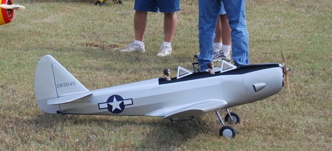

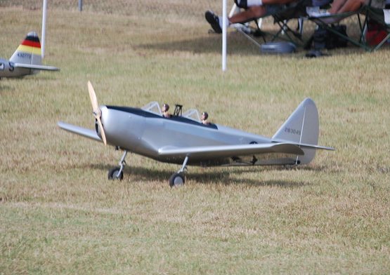

Last weekend the PT-19 made a number of flights at the GSWA fly-in held at Firetower Field in Easley, SC.  Here are two photos of the airplane taken on the ground.  So far I haven't found any airborne shots on the server.  If I find them, I will upload them and post them to this thread.
