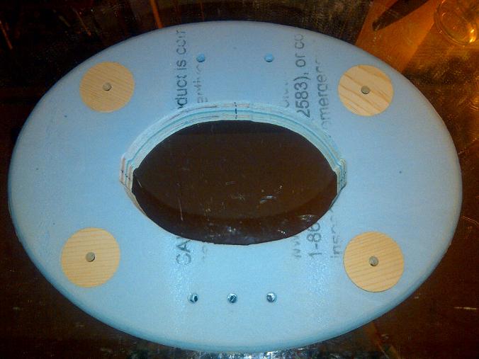

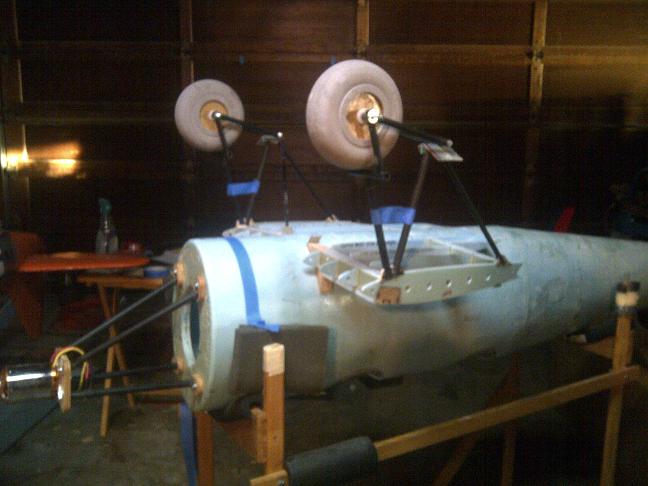

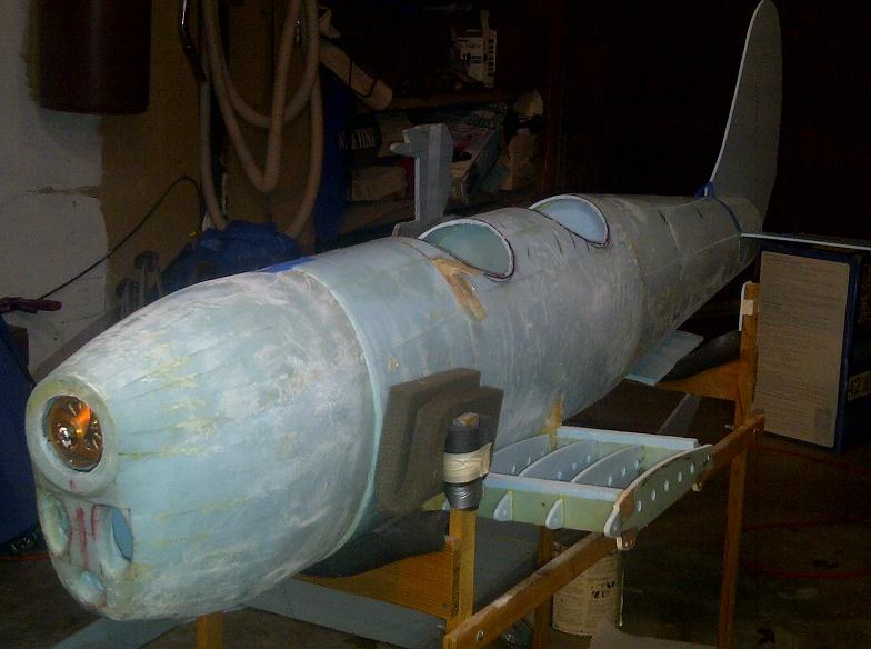

The Ryan cowl was made along with the fuselage on a saw horse made for the project. All the bulkheads from tail to cowl slide on and then same 1/4 inch underlayment foam wraps around them.  I use gorilla glue because it has good working time and expands just enough for good coverage with the totally blind installation of the skin.  The foam will take a slight compound curve but I had to relieve it for the forward half of the cowl where it attached to a block of foam.  The cowl is mounted to four brackets back at the firewall.
