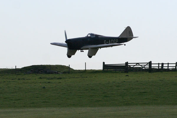

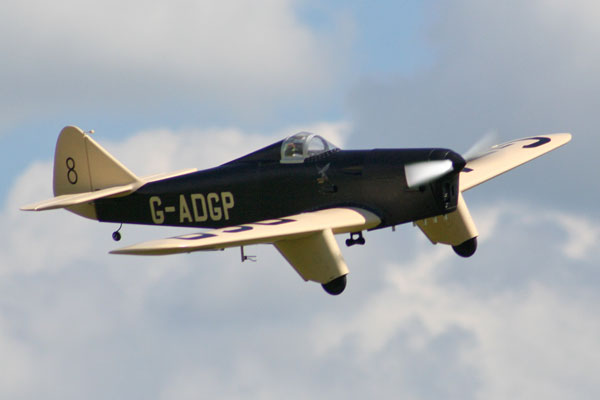

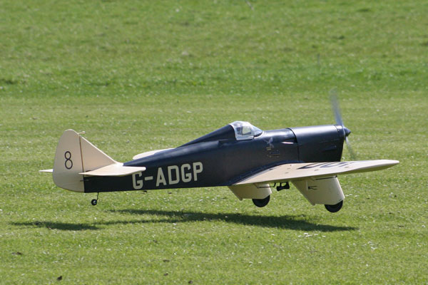

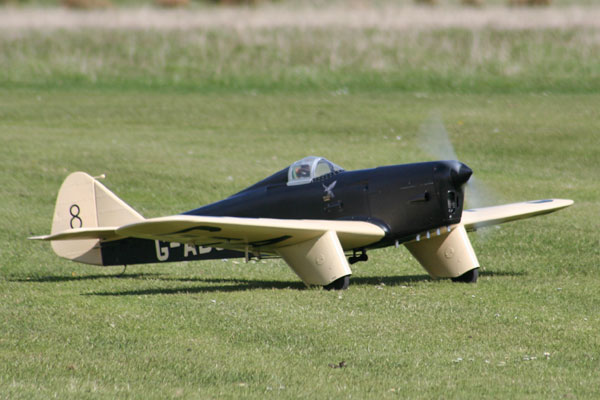

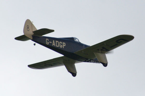

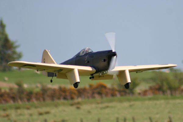

I successfully test flew my Dad's 27% Speed 6 on Saturday....................2 further flights followed on Sunday. Not 100% yet, still a little adjustment of the CG required and a check with the incidence meter of the stab incidence as excessive up trim is currently required for level flight indicating a possible rigging angle problem. Model built from an enlarged Phil Kent 1/4 scale plan, so any builders of this model be aware and check the stab incidence as there may be an error.

 Wonderful. I have had set of those plans for along time and now I think it might have moved to the top of the never ending list.
 Did you fly it with the G-38? I would have thought it needed a bit more than that.

Quote: p51p47

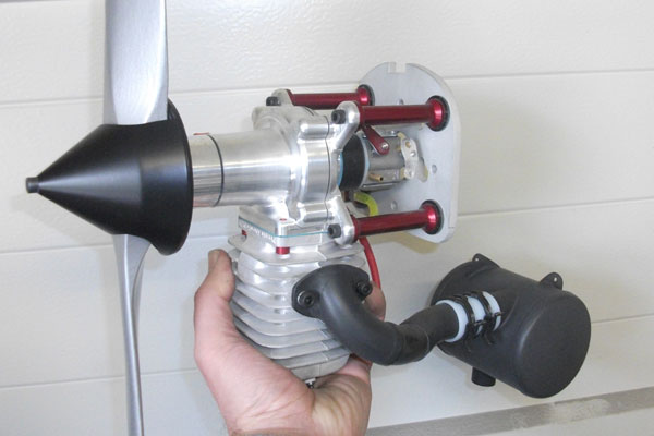

He's re-engined with a DA50 as the AUW was creeping up and he thought it may struggle a bit on the original ZG38. 1st engine runs have been carried out without drama......test flights are due when the English weather finally decided to sort itself out.
See above.............

This is the front end set-up.
