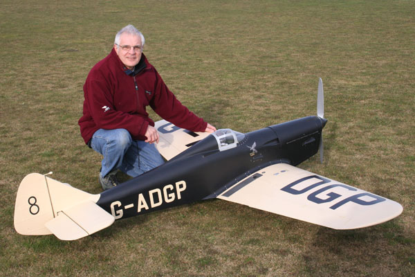

It's been a long time coming, but Dad has finally finished his Speed 6 (10% enlarged Phil Kent plan).
Covering was SIG Koverall followed by 6 x 50/50 thinned coats of non-shrinking dope. I lent my hand to the project with the painting......this used Warbirdcolors for the colour (RAF Black over grey cellulose primer, & WW1 Linen over white cellulose primer) with a Klass kote 'satin' clear coat over the top.
He's re-engined with a DA50 as the AUW was creeping up and he thought it may struggle a bit on the original ZG38. 1st engine runs have been carried out without drama......test flights are due when the English weather finally decided to sort itself out.
