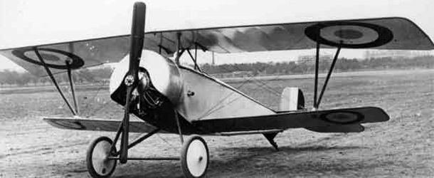

  Hi. My name is Cliff and I am in Australia. I am close to finishing  a 1/4 Nieuport 11... Just wondering whether anyone has diagrams for rigging same. Kind regards, Ancient Cliff

The N11's rigging is fairly straight forward: Two landing wires from the top of the cabane struts to the bottom of the "V" and two flying wires from a point near the lower wing leading edge to the top of the V.  There are also cross-bracing wires on the front of the undercarriage and between the forward cabane struts.
A google search for Nieuport 11 will turn up hundreds of images showing the rigging.

Hello Cliff,
the original 556 out of the Musee de l'Air at France.

Thank you Matz. Those are wonderful and clear pics. Easy to follow all the rigging and anchor points. I am now keen to get to that part of the build. The model is a kit from BUSA and I’m not intending it to be a true scale. It’s just a weekend flyer that looks interesting. I’ll be 76 in a few months and I still have a DB Sport Se5a and aMick Reeves 1/4 Camel to build before It’s too late. Those two I’ Really put effort into. Kind regards, Cliff
