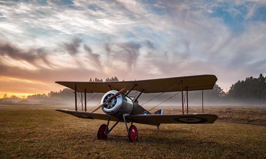

This 1/3 scale pup was built from a Balsa USA kit with many modifications to make it more scale.
It has a Zenoah Gt-80 engine
Wingspan:    108 inches
Length             77 inches
Height:          ; ;  37 inches
Weight:          ; ; 44 lbs.
Covered in Solartex and the roundels were hand painted.
The aircraft was painted with latex matched to paint samples that were supplied from the Hendon Museum
in London England, and authenticated by Mick Reeves.
The wing covering was hand stitched.
The fuselage side covering was also stitched after installing the eyelets.
The flying wires were made from flat stainless steel to simulate the actual flying wires of the original.
The flying wires were also attached to the landing gear through the lower wing as was the original.
The landing gear was welded up using tubing and plans supplied by Mick Reeves.
This photo was taken at the Blue Max contest in Sanford FL.
The fog was lifting fast so I didn't have time to install my scale propeller that I hand carved.
I'm kind of proud of this one. Thank you for letting me post and brag a little which I normally don't do......Ron

Posted: June/27/2016 at 6:23pm  Quote
Ron,
Wow!, that is a gorgeous airplane.

Posted: June/28/2016 at 6:45am  Quote

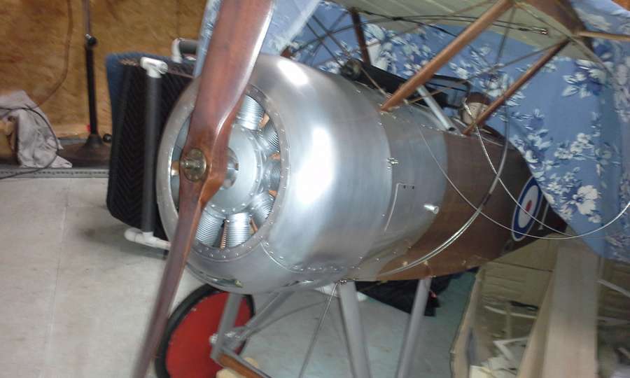

Thank You Patrick, it has everything the full size plane did except the band around the cowl to hold it on, I couldn't cut into that hard cowl to do that, I had to heat the cowl in order to straighten out the BUSA cowl to match the original and add that reinforcing band on the front of the cowl, plus the cowl is a little thin.
I have the prop nut on backwards because I just put the scale prop on to see what it would look like, any questions, I would be happy to answer them.....Ron

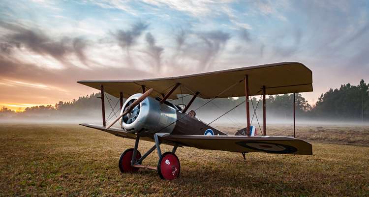

Posted: June/28/2016 at 6:58am  Quote
Here is another slightly different angle showing more fog as it was lifting a neat photo.

Posted: June/28/2016 at 7:15am  Quote
Wow. Doesn't that look awesome. Well done.

Posted: June/30/2016 at 10:54am  Quote
That's a beautiful plane and a great picture! You need to make a big print of it and frame it.
