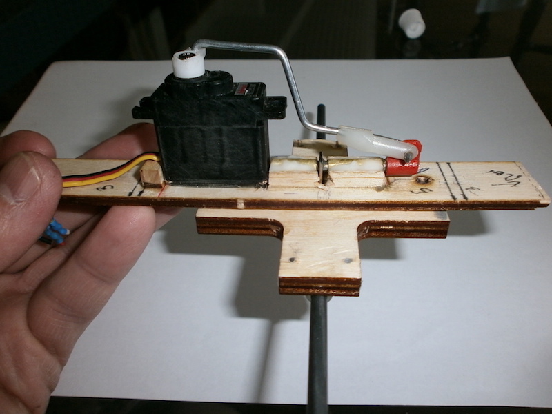

So you must have your dolly setup with a release servoe? it also looks like you have elevons.....even using the inner surfaces. that is how mine is setup.

Yes the dolly has a release servo...check the pictures below. Also this set up allow me to have access in case something happens with servo etc.
The set up is elevon but the inner is also trim flap.So in flight you don't use the normal trim but the flap trim.By doing so you have better control and for pitch trim you don't deflect any of the outer surfaces....

And here is a small video from dolly drop test...it is simple and works well.
