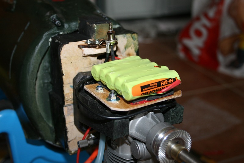

Tubig: Marutaka offers great kits and catch very beautifully the warbirds lines. On the other side these kits are a bit heavy as Marutaka use a lot blocks of balsa.So there is a lot of sanding. Try to keep the tail as light as possible practicable and move servos and battery forward.
For exhaust I used the "Turboheader" product. The design was initially for SAITOs and short after expanded for other 4T engines like OS etc. Have a look on the photo below. The design offers a lot of flexibility and you can squeeze the exhaust inside the cowl. In my case the exhaust is not installed as I did some trimming of cowl. What stays out is the last 1/3 of pipe. I try to post one photo when I am back home.
