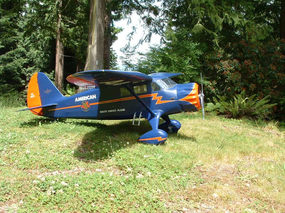

1/4 scale Stinson "Gullwing" SR-9. I Built this about 12 years ago from Richard Barron plans. 124" WS, G-62 power, weight 35 lb. Barron drew the plans in the early 80's and they are works of art and exact in all respects. Needed to do some "modernizing" to reflect the current state of the art, but that was just electronics and landing gear upgrades, the drawings and material sizes are pretty much spot on.  The cowl and wheel pants are still available from Fiberglass Specialties. Wonderful flying plane.

Thanks.  Plane was fun to build, the shape of the wing required it be built "above" the plans.  That was a fun challenge it required stand offs and lots of squares to be sure the stuff in "space" was in the correct place.  I had intended to detail the interior, but somehow never got around to it, but I still have all the bits and pieces if I ever run out of projects which doesn't seem likely LOL.
