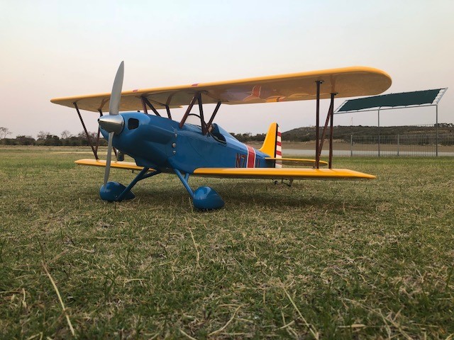

Hi Avipatable,
I've just completed and maidened my own Sig Miniplane. It flies great but it does balloon! I tried to add a little bit of negative incidence on the stabiliser but it obviously wasn't enough, so I'll try what you did with the shims under the rear of the top wing.
Still, it flies great. 3 flights in so far and hopefully a lot more to come!
Posts: 8289
Posted: May/14/2018 at 7:56pm  Quote
Did you add 1/8" to the LE of the stab or something less?
I know it sounded crazy but I tried to help remove the drama on flight 1.
Glad it went well.
Avatar User Online Guests
Guest Group
Guest Group
Posts: -3252
Posted: May/14/2018 at 9:07pm  Quote
Only about 1/16. Wasn’t enough! Can’t adjust the stab now so will have to try some wing adjustment.
Still, it’s better to be going up on a maiden...
Joined: January/23/2011
Posts: 188
Posted: May/15/2018 at 2:30am  Quote
Hi WRA,
That's a nice finish you have on your Miniplane, and congrats on a successful maiden.
It sounds like we might meet in the middle with regards to the incidence. I put 1/8" under the stab, as per Sparky's recommendation, and under the rear wing bolts of the top wing I put a square of what I think was 1/16th balsa - with a hole in the middle for the bolt. The struts were soldered to suit. But I think it is a fraction too much - at full throttle on take off the model would quite happily keep ripping along the sand rather than lift off gently on its own accord.
Let me know how you go!
Sam
Posts: 8289
Posted: May/15/2018 at 10:04pm  Quote
I told you 1/8" no body believes me...
It really needs it. This was my first scale airplane many years ago that had the decaladge way off. I'm sure there were some maidens taken to tears because SIG stuck their head in the ground and didn't fix the issue. SIG knew all along there was a problem.
