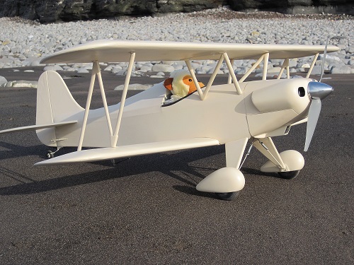

I have finally flown my Sig Smith Miniplane... It is my first kit build and I wrote on RCSB about 2 years ago asking questions to try and make it a little more scale.
Due to long work hours and stay-away jobs it has taken an age but I have finally got it to flying stage - and now I know it flies I can attempt an ambitious paint scheme (for me at least) and add the flying wires and other details.

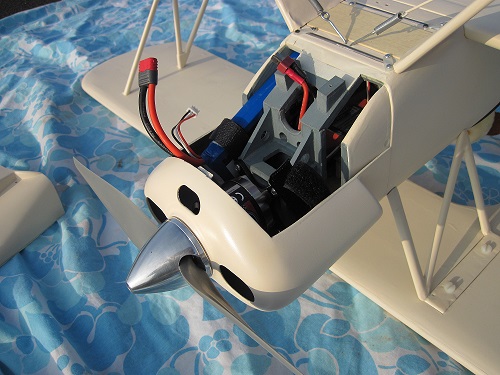

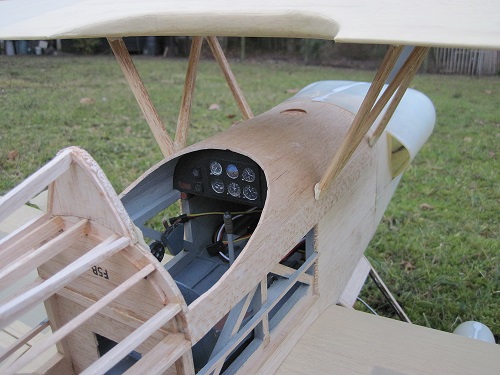

The model is electric powered and I have made a rather over complicated battery installation to keep the weight up the front. I made my full depth (sport scale) cockpit and changed the undercarriage and added  springs - I thought the original was rather ugly and google shows a number of full size owners thought the same!

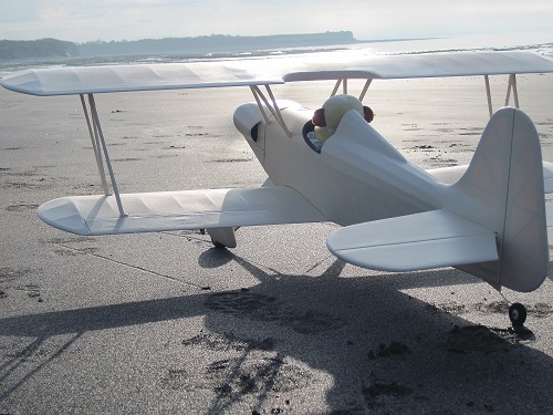

I had 3 flights and was very happy that only a minor trim adjustment was needed. Apparently a number of builders say the model balloons badly so I followed the advice of Sparky and one other chap who's name escapes me. I put 1/8" balsa under the front of the tail plane and 1/16th" under the rear wing bolts of the upper mainplane. However, I think this has overcooked it! The model bombed along the beach at full throttle and had to be pulled off with elevator. It flies like a bullet - rather how I would imagine a P47 and not a little biplane! It is also quite reluctant to go over the top of a loop.
I will remove the wood under the bolts on the mainplane and see what happens. The C of G is also very slightly forward of the plans, but I left it as it was as adding the details will probably rectify it.
The finish is a bit of a "good from far but far from good" but I am pretty happy with it - the next lot of paint will really make it stand out.
Any comments or advice to get her flying more daintily would be much appreciated.

I am very happy that my advice was taken on board. The drama I had on my first flight is still fresh in my mind and that was 1977 or so!
It sounds like the declage fixed the issue. What will the final color scheme be?

Hello Sparky, nice to see you checking in. Yes I followed your advice with regards to both the tail plane and wing incidence changes, and keeping the weight forward too. Do you think a slight reduction in the packing behind the rear wing bolts might aid with making it a little more floaty, or is there something else I should try first? Stick movements for flight are considerably more than with my other models so I will wind back the expo – it was set to 30%. I will scan my drawings of the paint scheme I hope to do and post them tomorrow. I am worried about seepage with solartex!
Hi Erez, thanks for your kind comments, low resolution photos work well ;) Nice to hear yours is a good flier and can fly slowly… it gives me something to aim for. Mine flies well – but flies a little bit like a pylon racer! Landings are a bit like a WW2 novice carrier pilot’s first deck landings! I did 3 and the last one was a greaser – but still fast (the first two would actually equate to about 8!).

More flying will definitely make you more comfortable flying the plane, at the time I flew the plane I was a a intermediate model pilot and radios were never like they are today so my experience was a bit different then yours.
30% expo seems high but adjust to the way you like it.
If you would like to remove the shim from the wing, take out half the thickness see how you like it and if you want to continue back to the factory setting take the rest out. I don't recall the weight of my plane but I don't recall it being a "floaty" airplane. Play with the CG as well but do it after the painting. If you paint the model there is more surface to paint aft of the CG so it will migrate aft with a paint job. If you are coming from the Foam ARF world all wood models will seem not as foaty as those planes as they enjoy a considerably reduced wing loading and higher power loading.
I am sure there are tutorials on painting that will make the painting a little easier. If you are worried about seepage along the mask line, lightly fog the trim line with the base coat color so any seepage is the base coat.
