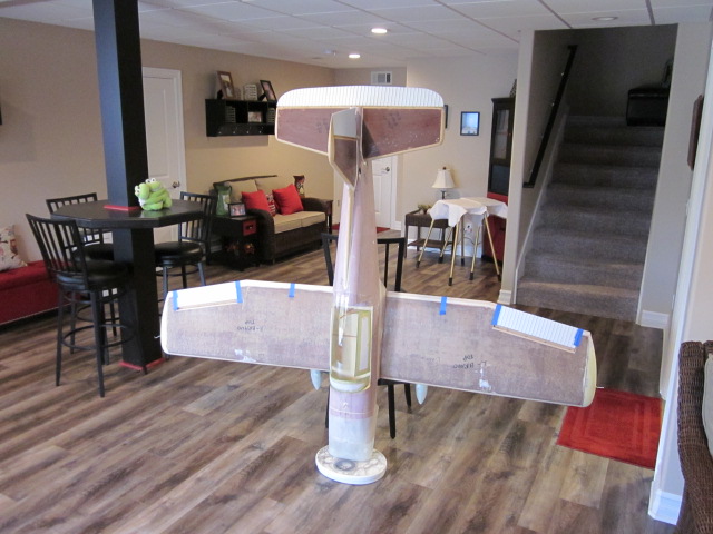

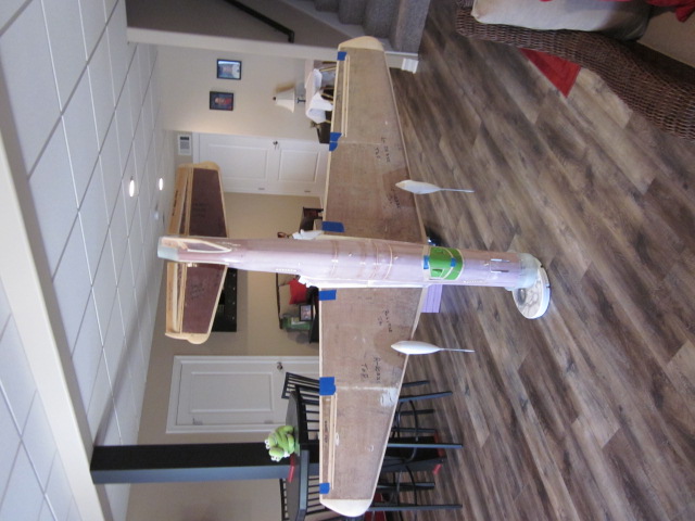

Thought I would post my winter builds
DO335 (Masters plans)
Wings, stabs covered with brown paper
Canopy opens and closes with servo
Wing span 91"
Weight as in PIC 13#, should be around 20# RTF (that should be very lite for a model this big)
(2) 1,100 watt motors, (2) 6S1P-5000mah batteries (one per motor), MA 3-plade 16x10 props normal and reverse
2 piece wing and fuselage splits(center) apart for easy transport
Camo green, brown and maroon: primer Kilz and flat interior house paint
Bravo (Sig Plans)
Wing span 86"
Weight as in PIC 15# should be around 24# RTF (should be a good flyer at that weight)
2,400 watt motor, (2) 6S1P-5000mah batteries configured 12S1P-5000mah, APC 18x10E
Camo white, gray, black and orange (different): primer Kilz and flat interior house paint
Stay safe

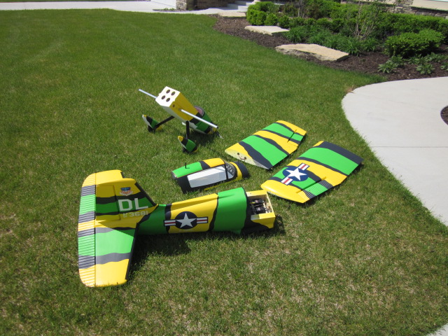

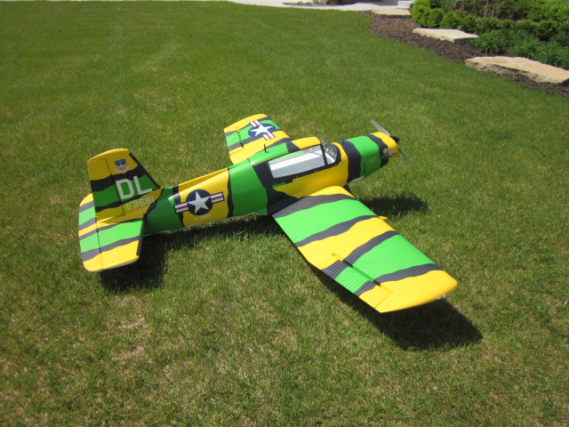

Michael
My Connie is built from foam using the same methods as the above planes. This is the build thread for the Connie.
https://www.rcscalebuilder.com/forum/forum_posts.asp?TID=278 76&PN=1&TPN=1
Also good reference book is from ParkFlyerPlastics.com "building with foam".
https://parkflyerplastics.com/cart/index.php?main_page=produ ct_info&cPath=29&products_id=644
PIC is my last year foam build of 76" ME262 14# (can see it in Connie thread). In the process of repairing the airframe, 1st EDF build using 1965 plans from Germany. My EDF design was very poor, crashed the model on 2nd flight. After crash did a lot of design research (mainly looked at large Freewing ARF EDF planes and found my mistakes. I had to replace the 50mm canon with 400mm cannon to give the ESCs more cooling air. The plane now fly's great. No PICs because plane is bad looking but hoping it will be PIC worthy this summer.
Tony

Bravo is almost done
Very different paint scheme but I like it should be easy to see.
Comes apart for easy transport
Now on to the DO335
Tony

Posted: 24/July/2020 at 7:51am  Quote
DO335 done
WS 94", 28#, (2) 1400 watt motors, 6S (2-6200mah) MA 16x10
Not flown yet
Tony
