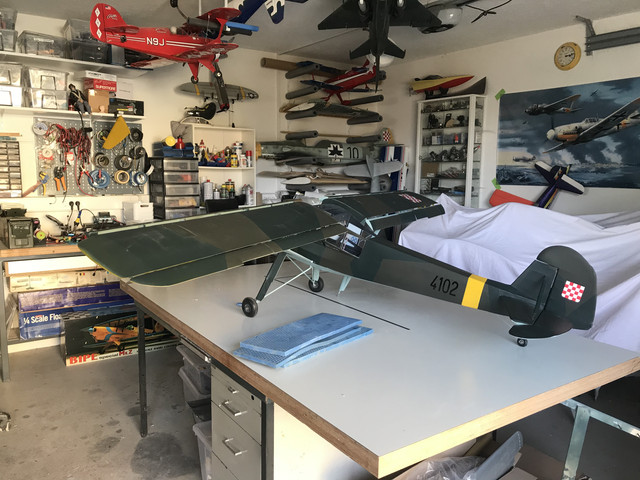

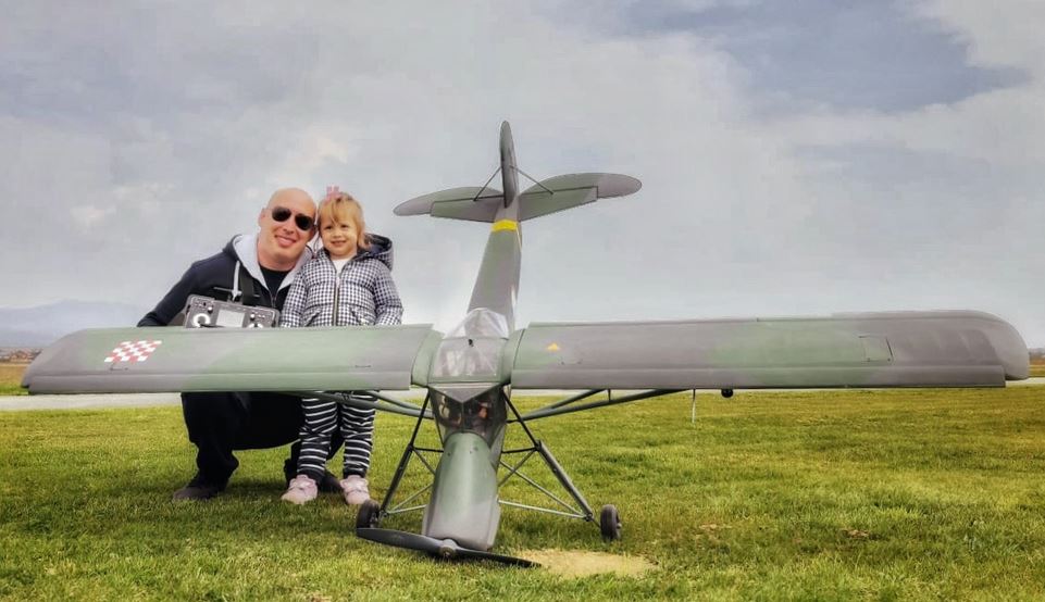

Sure Bob, so i bought complete plane but it was missing some crucial stuff like cowling, wing struts, one part of landing gear, and some ribs were broken on the tail and wing.
Biggest job was how to strip down paper finish and to bi done with oratex.
So after around 80 hrs, it was done, and then engine setup.
Point is that this engine is oversize for this model, but after first flight and 5 more flights i can tell you, it flyes as the same speed with 50% or 100%. Point is straight wing with fix slots and bunch of drag from tail/landing gear/wing struts.
As I have been at real one, i can tell you, it fles just like the real stuff and i`m in love with his flight envelope.
Now some bugs are comming out, and i have to move CoG little aft, but final conclusion is that if you find out for Svenson Fieseler kit, go for it.

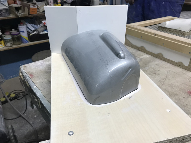

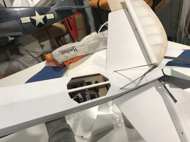

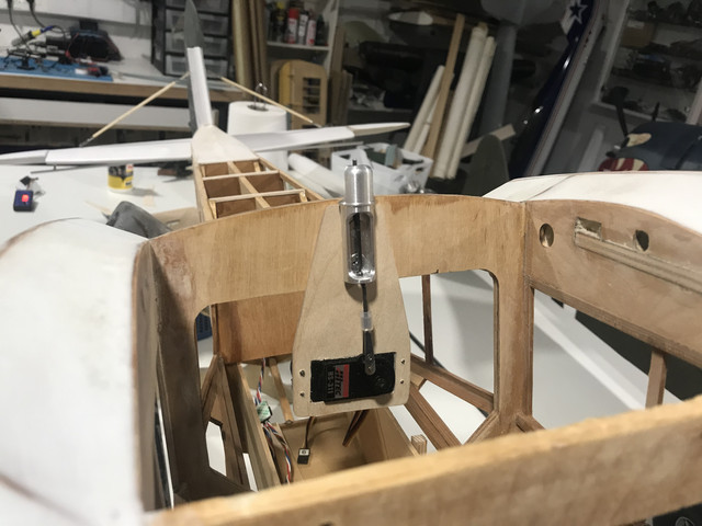

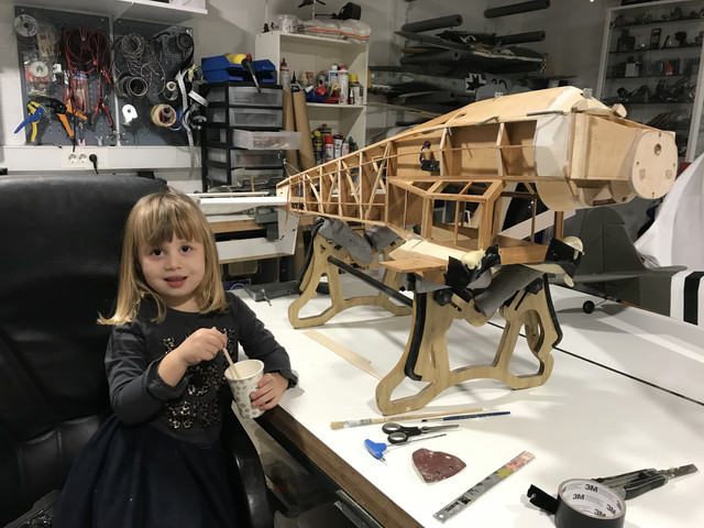

As my Fieseler had Midair collision last year and it was really painful to see 80% of stringers and bulkheads cracked i got new kit and build it. Bunch of upgrades and now it will be 500grams lighter as old one.

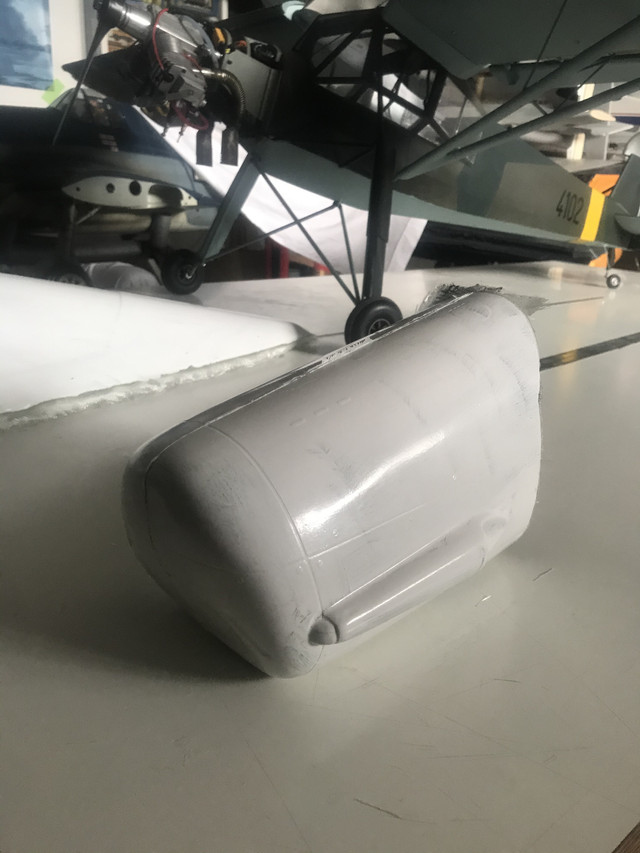

Also i build mold for scale cowl so now if someone need 1:6 scale its ready for production:

Krkan , The Storch is looking great . I watched your YouTube video and that Laser 1.60 sounds is awesome . I have 2 Laser 200v engines and I absolutely love them . I changed one of them over to ignition but still on glow fuel and it runs really well with an incredibly low , stable idle. I was looking around to try to find a larger cowl for my Dennis Bryant Storch so I could fit a laser in it . Would you please PM me the details on price and shipping on the cowl you're producing.
