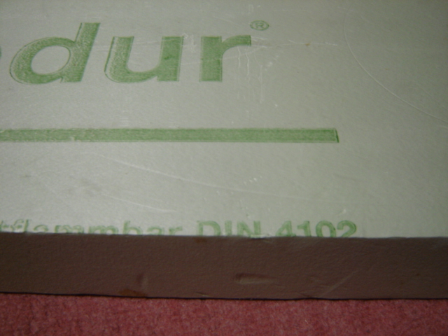

the tail is made from foam (Styrodur), i.e., formed by cnc milling. So, this stuff is very light to save additional weight in the nose.

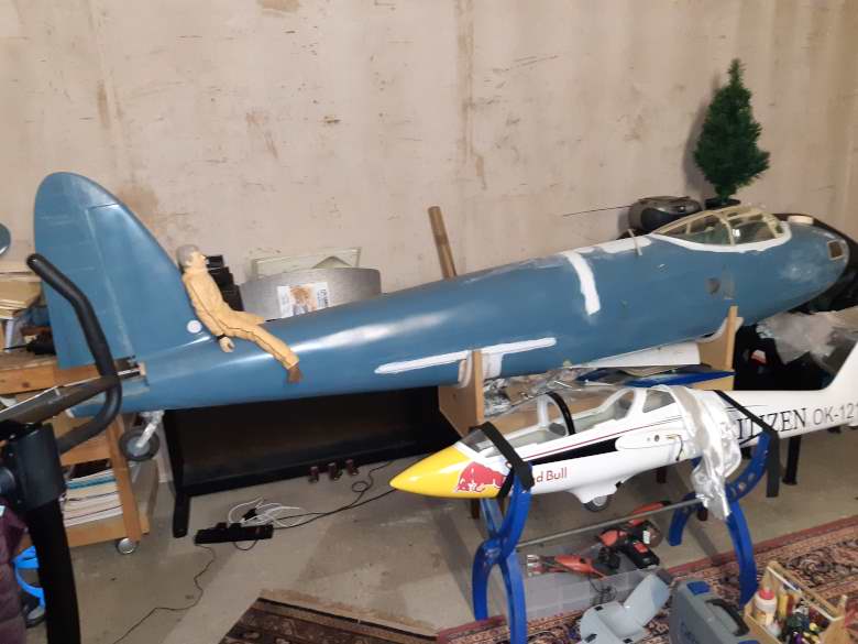

This is Richard Rawle's latest Mosquito. It is 30% . Power is 2 x Valech 120cc fc.
About 5 mt span.
He has been building it 10 years, (with distractions) but it is nearly finished

I'm not familiar with styrodur does that need to be glassed and does it require extra reinforcement?

The tail made from styrodur is glassed, in order to obtain a permanent surface. It works with parts which are not integral or load-bearing parts. Actually, for forming parts it is an excellent material.

PS, What is styrodur,  Styrofoam?

styrodur is some kind of foam which has a higher density than Styrofoam. It is a bit heavier, but it can be milled and/or even processed with a cutting wire. I´m not sure if styrodur is simply a trade name. Usually, it should be available in building centres.
