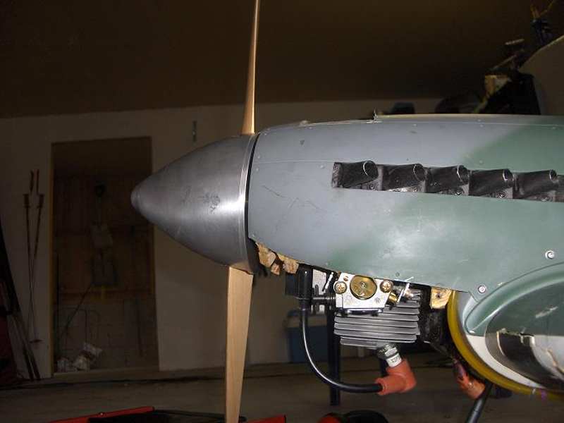

Avatar User Offline Keith
Joined: February/29/2004
Posts: 563
Posted: April/01/2018 at 2:55pm  Quote
Thanks again for your input guys. I've looked at the various replacement engine options, dimensions/weight etc , and I think without too much retro fitting, I'm going with a zenoah 38. One reason being the 38 weighs 4lb, this is usable ballast , and will hopefully get me out of the balance predicament.
I will be looking to get the engine fairly soon, but waiting to see if a second hand one becomes available with carb bend and trumpet.
Kwik, do you by any chance have any pics of your Typhoon with the zenoah set-up, if so could you post pics.
  All the best
                 Keith

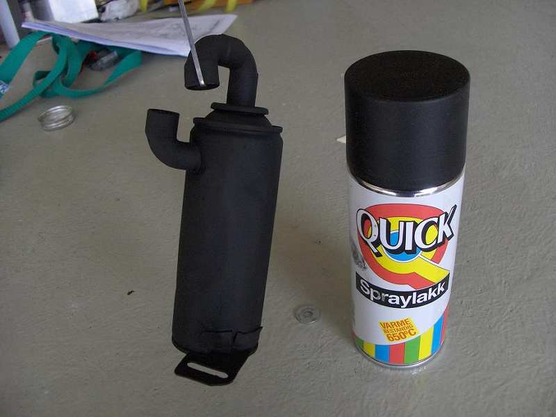

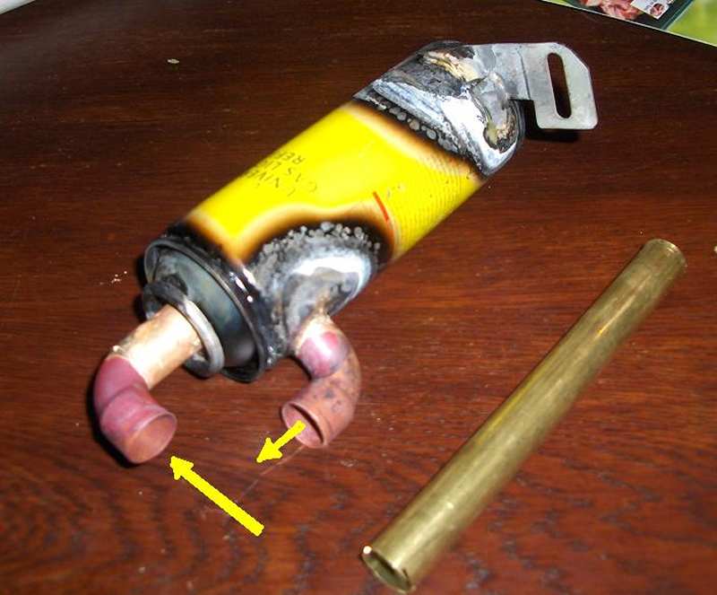

Avatar User Offline kwik
Joined: March/27/2004
Posts: 4116
Posted: April/01/2018 at 3:18pm  Quote
I have some photos....
The muffler shaked apart in the silver dolder joints. The walls in the spraycan was too thin....
