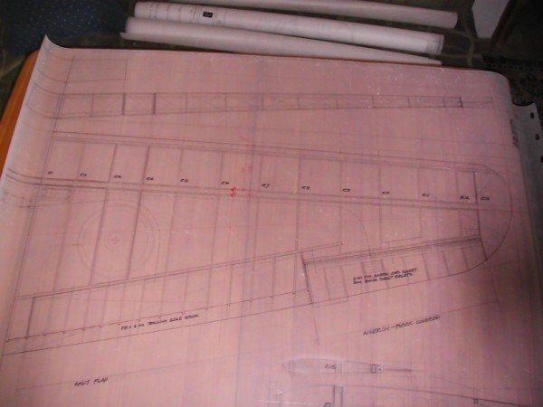

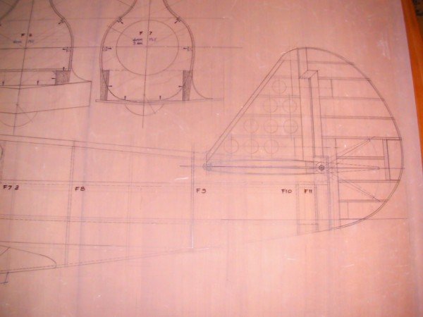

I started drawing the plans, by hand, on a drawing board, after hours at work in April 1995 and started construction in November that year. This was in Johannesburg South Africa. I finally finished the model in Bulgaria in 2009 after dragging it from Johannesburg to Cape Town to Dublin and finally to Bulgaria in 2007.

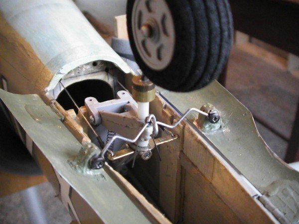

  • Own design brass oleos crushed on maiden flight. Changed for Sierra retracts and better 6061 T6 alloy home grown oleos.

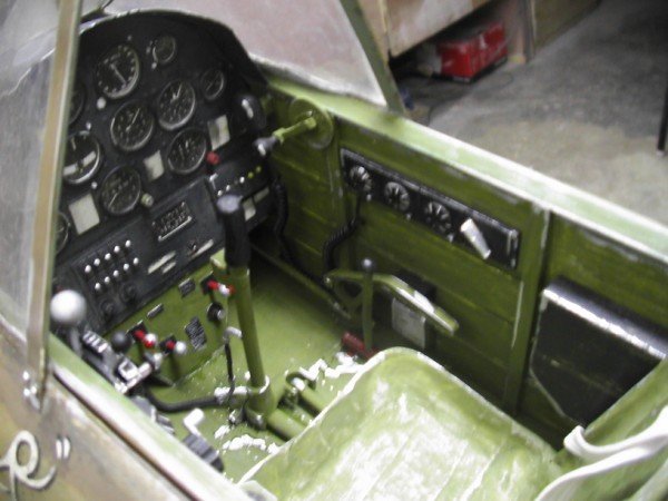

  • Cockpit completely scratch built. Instrument faces are photocopies from a book.

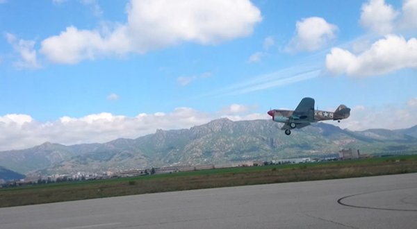

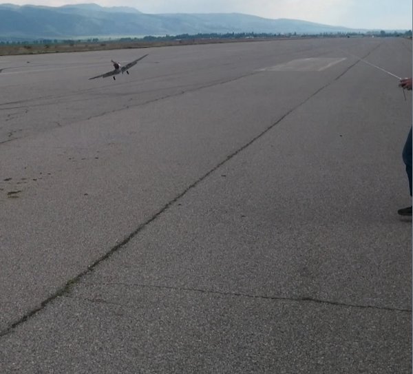

Takeoff.
Fly past.
Gear check.

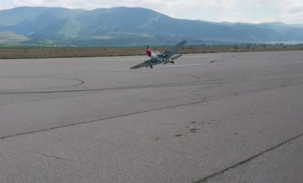

Touch down.
Oops! Wing lift.
Power up for go around.
Clawing for altitude!
OK ... Phew. Leveled out.
Turning onto final.
Touch down ... Again.
That eureka moment.
"Almost lost it there around the stall and flair".
Debriefing.

Hand drawn plans. No CAD in those days.

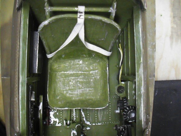

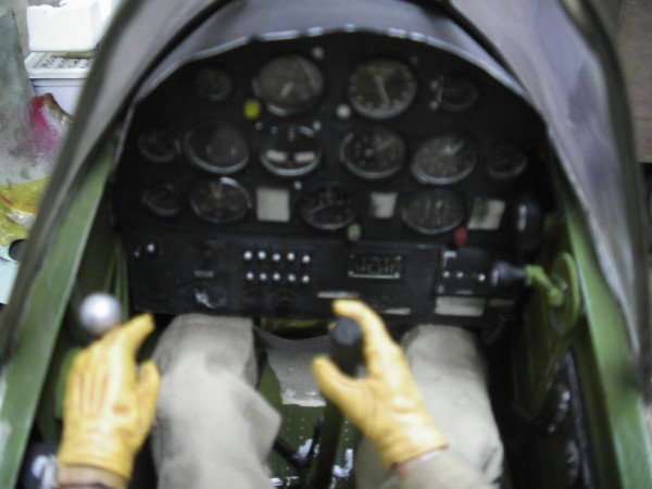

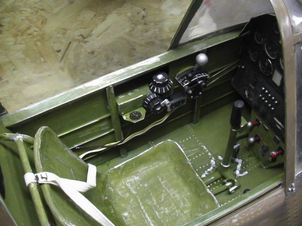

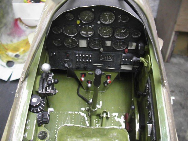

The office.

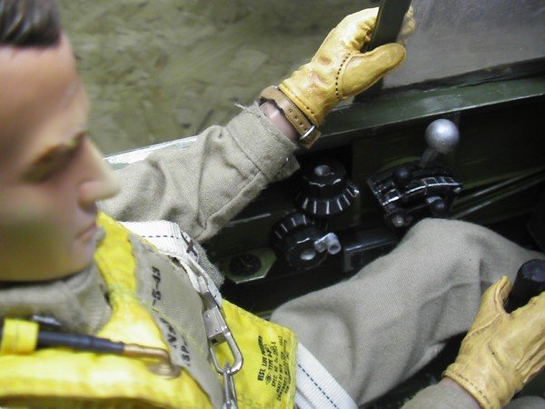

Throttle quadrant, rudder/elevator trim wheels.
Canopy crank, radio.
Joy stick, floor.
Seat. It's a plastic milk jug with ali tube frame. Seat harness is elastic.
Bit of wiring and a few push rods.
Cowl shutter lever, emergency hydraulic pump and map case. Knobs, switches and buttons.

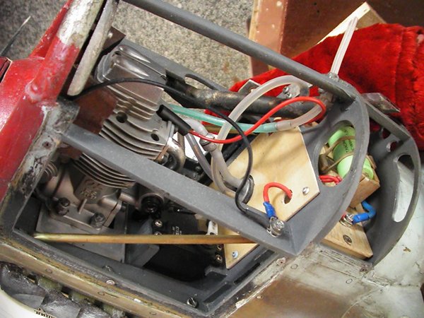

Engine bay. Home grown exhaust.
Tail wheel. Pull - pull steering.

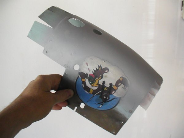

Fiber glass cowl under going some repairs.

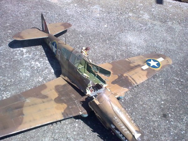

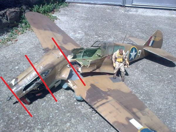

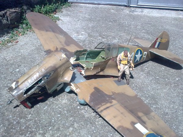

As Commanding Officer of the 59th Fighter Pursuit Squadron flying out of Tenevo Bulgaria, it is with great sorrow and regret that I have to inform you of the immediate demotion to Flying Cadet of Lieutenant Pilot Officer J. J. Parsons, pending an official investigation into the cause of the disastrous "incident" which occurred at approximately 0:1300 Hrs today. Lieutenant Parsons was on a search and destroy mission against enemy aircraft raiding from the North. Eye witnesses said that shortly after take off and a circuit around the field, the engine suddenly failed. Lt. Parsons, who survived the "incident" confirmed this, adding that all electrical control and communication was lost. As can be seen from the appended photographs, the damage is extensive and according to the aircraft's Crew Chief, Sargent Erwin, "may be repairable, given the resources, time and spares".
Lieutenant Parsons shamefully added that he was extremely sorry and should he be allowed to fly again. It would not happen again.

Crew chief Erwin has started the total strip down of the nose section and has informed me that the OS 120 E "Melvin" engine has a bent crank shaft.
Engineering has been organised for it's repair.

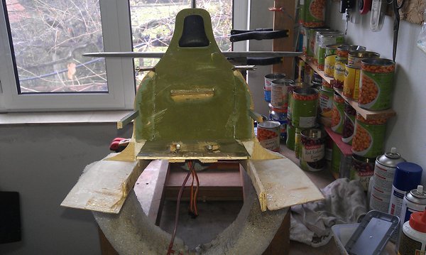

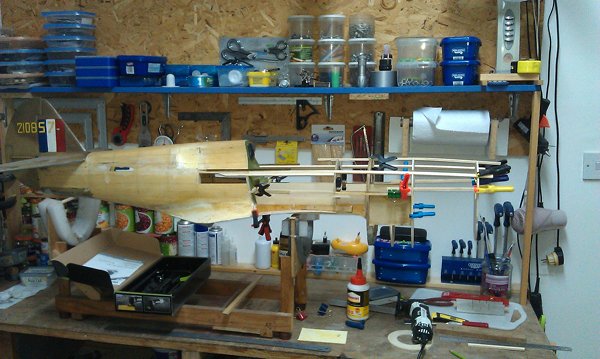

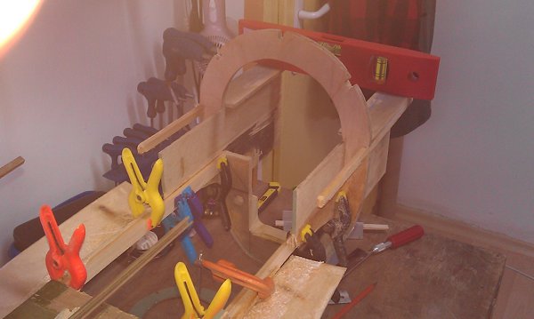

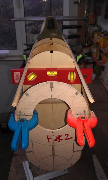

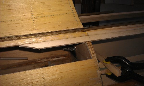

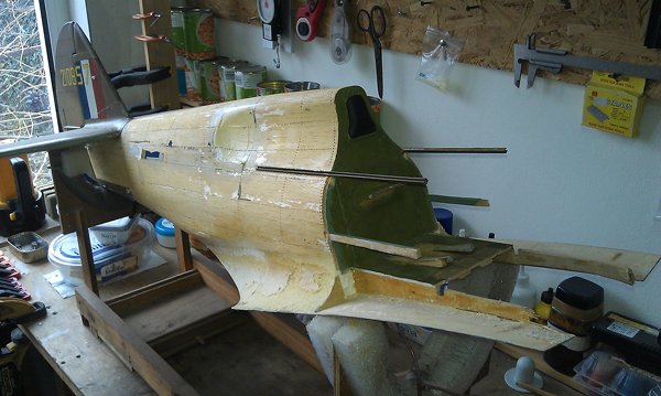

Removed the whole front of the fuselage as it was essentially already broken in two. Striped off all of the old Koverall, broken bits, set it up on my stand, sat back and thought.
The cockpit floor back to the front of the seat was removed and as much of the 1/64 ply wing seat was retained.
The wing fairings were originally built from expanding foam on top of polystyrene then fibre glassed. This was dug out.

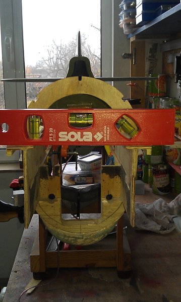

I decided to re build the front in two sections as can be seen from above. From the cock pit to the mid cowl is basically straight lines so was easy to get straight.
This is the first original section being spliced back into place along the wing seat line.
Keeping things level and plumb.

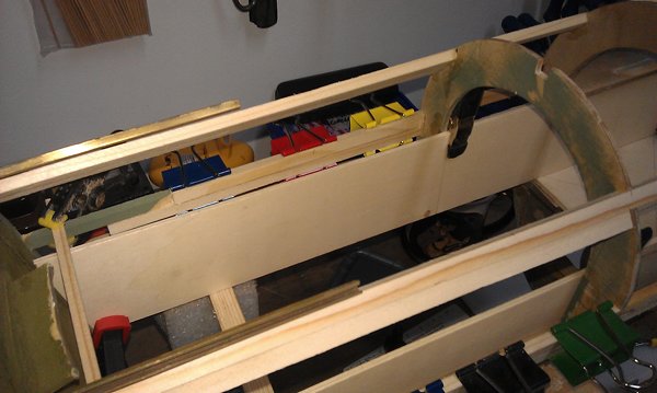

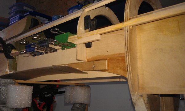

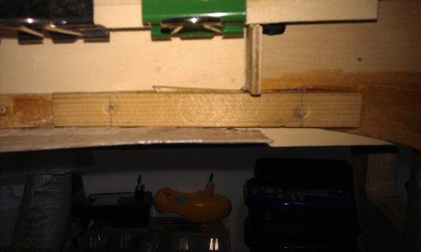

Light ply doublers were epoxied to the original ply fuselage sides at the wing seat level
 to strengthen the broken joint.
Then taller light ply cockpit sides were epoxied to the inside if the formers from
behind the seat to the front of that first section, on both sides.

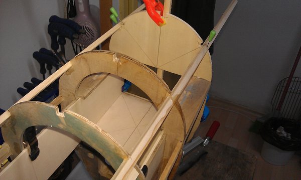

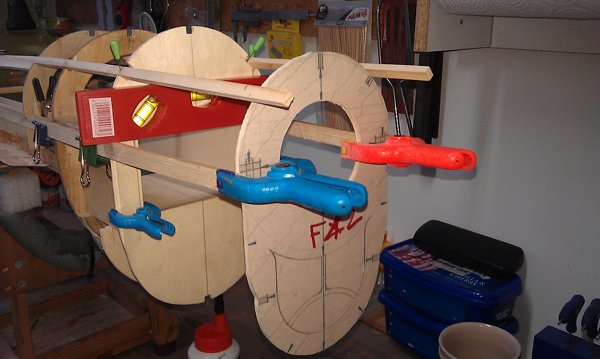

Balsa stringers were replaced with Bass wood stringers ensuring plenty of over lap with
original ones for stronger glue joints.

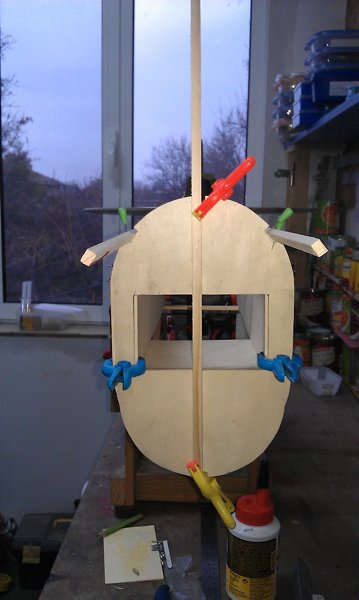

New former in front of the first section. This resulted in a tank bay box structure.
Stringers being set up for the next section to be re built.
The stringers lower than the cockpit canopy level got double stringers too.

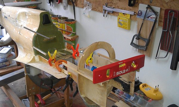

This piece was a temporary brace for the broken wing seat crutch repair and was removed.
Moving forward with stringers.
Sorting out the position of F2 and where the stringers land.
Needs to go a liiiiitle to the right.
Side view. Looking good.
