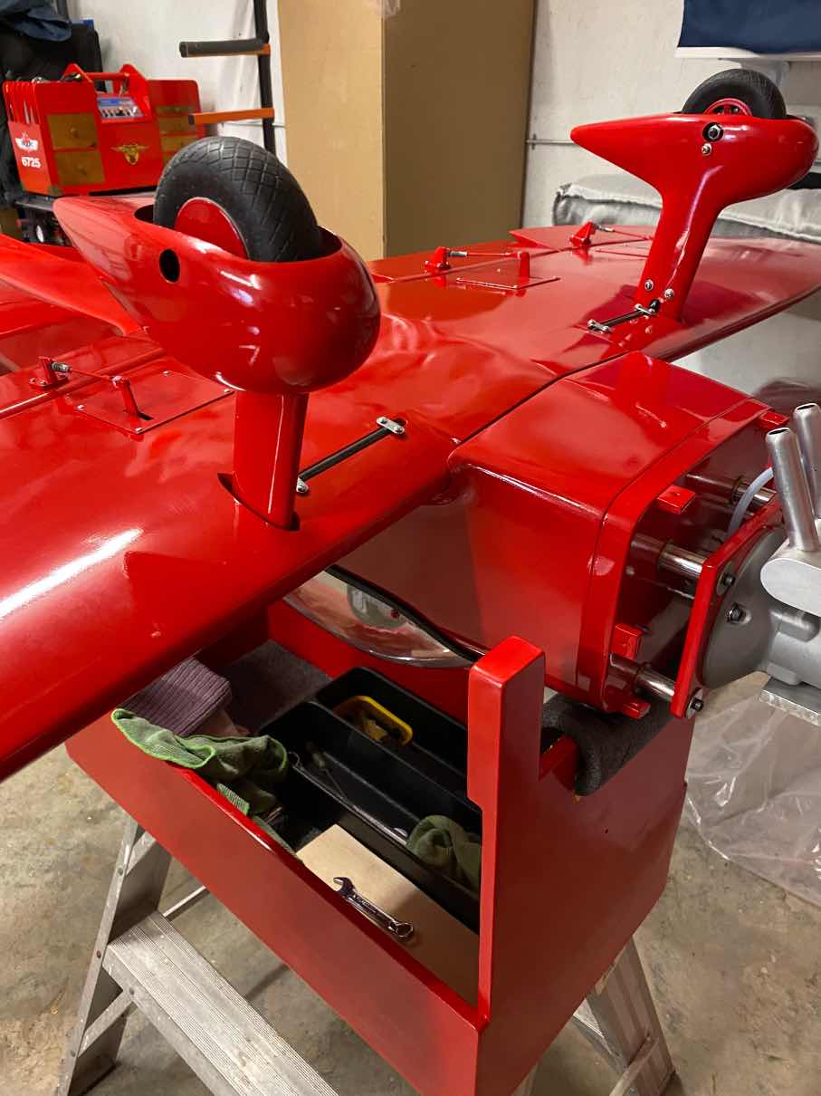

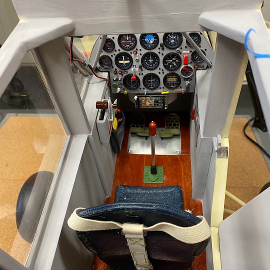

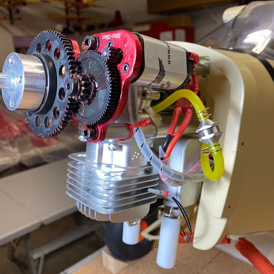

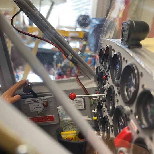

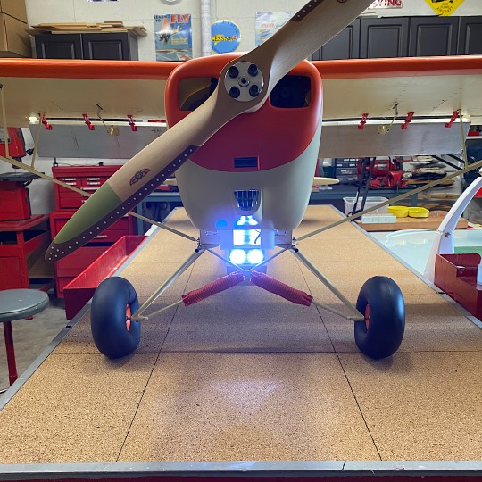

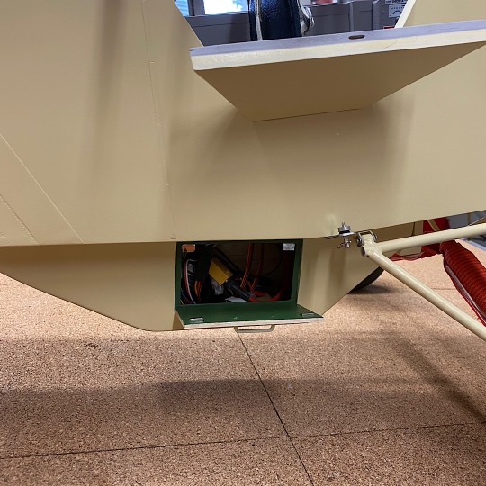

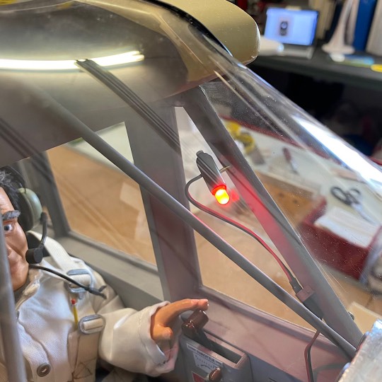

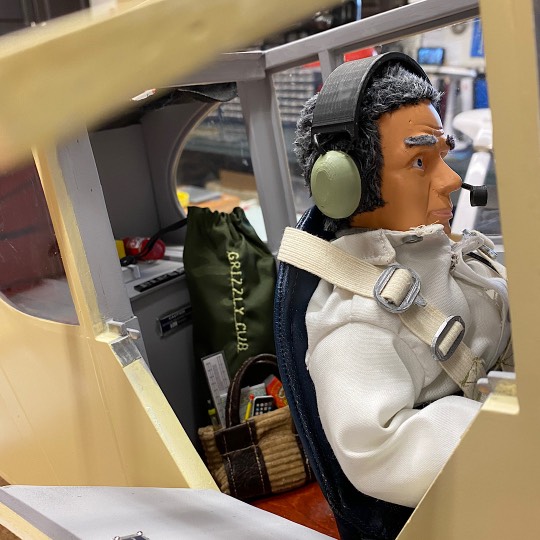

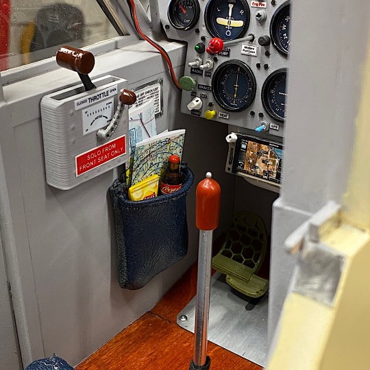

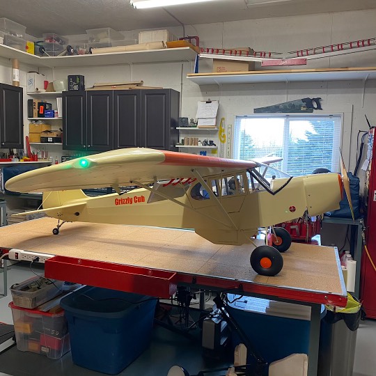

Hello, I’m relatively new to rcscalebuilder and is my first post. I just recently finished a scratch built Super Cub.( well except for a few more details to add) I used plans from a 1/4 scale Sig Cub and made the necessary modifications. I never thought to make a thread of the build. But I will on my next project. This cub is covered with Koverall and finished with dope. The engine is a DLE35 and has electric start, nav and landing lights, map light in the cockpit is the ignition light. The choke is a lever on the instrument panel. The landing gear is Robart gear, flaps are aluminum covered. Needless to say it was a bit challenging to hide everything, fortunately the cargo pod allowed room for the lighting and starter systems.

Boeing,
Wow, very nice. Will the maiden be soon?
The instrument panel nice and crisp. Took a second then saw the pocket with the map, bottle of Coke and bag of Lays!

Rick, very nice and glad you posted your finished project.  Nice work.  I like the coke bottle....

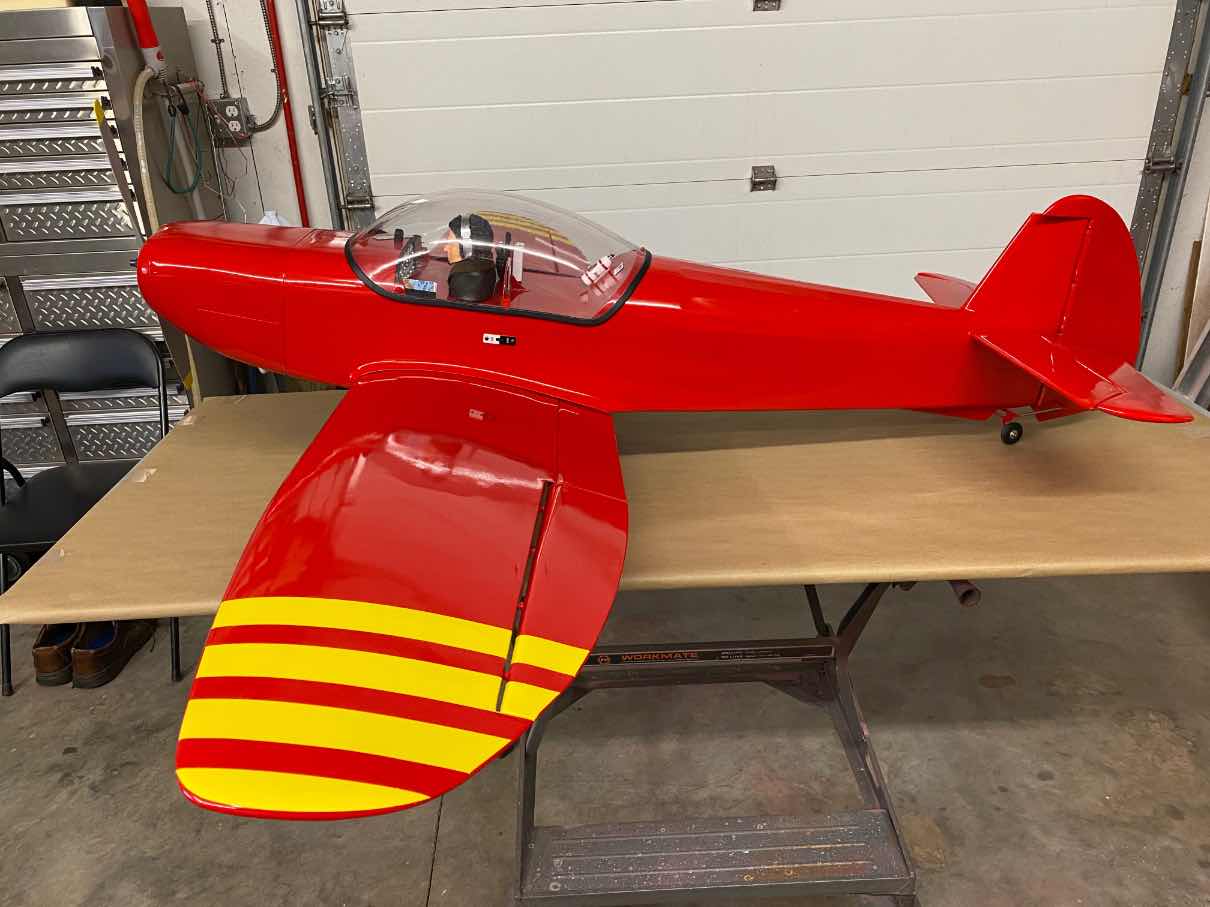

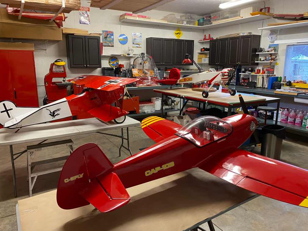

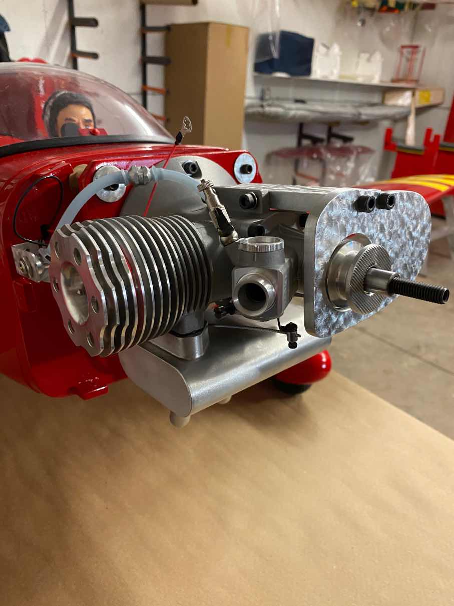

Thank you for the comments, as for maiden flights I have two planes that will have to survive. The Cub and a CAP 10B-pictured below. Just waiting for our field to dry up……
