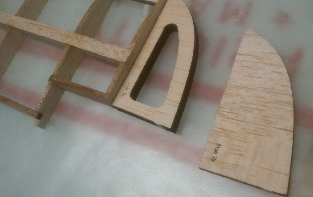

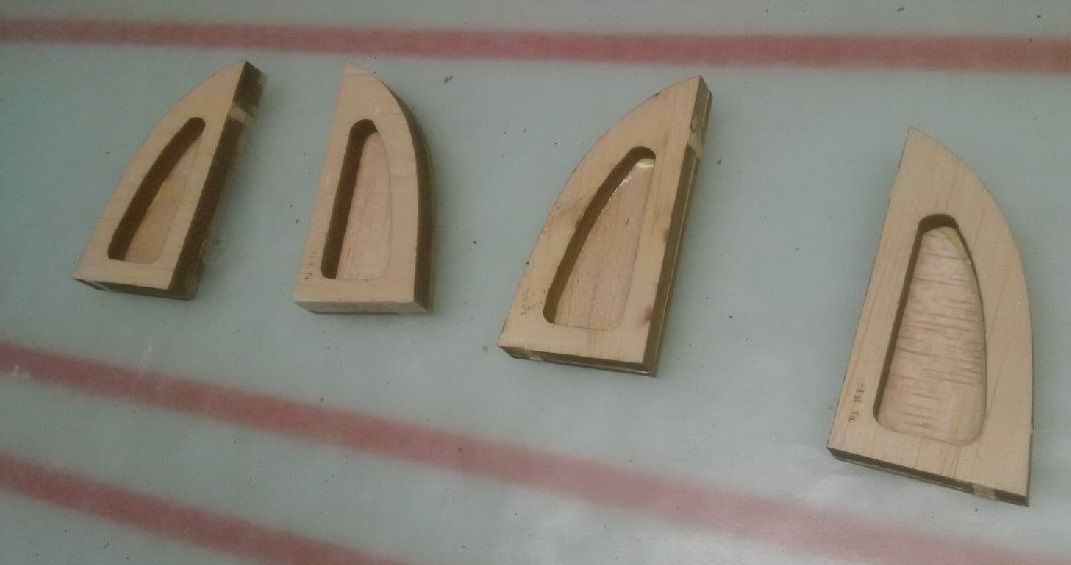

Next is the Stab tips made of balsa lamination.
JG

Posted: September/06/2018 at 10:33am  Quote

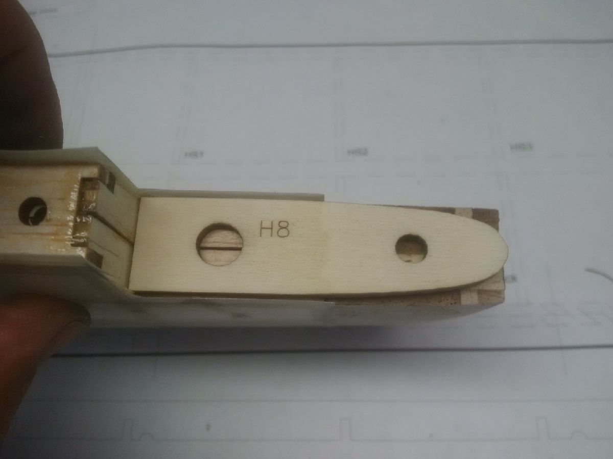

With the Sub L.E. in place, I glued the tip and realize I need another 1/16" layer to conform to the rib.
SO instead of 2 layers for each half, it will be 3

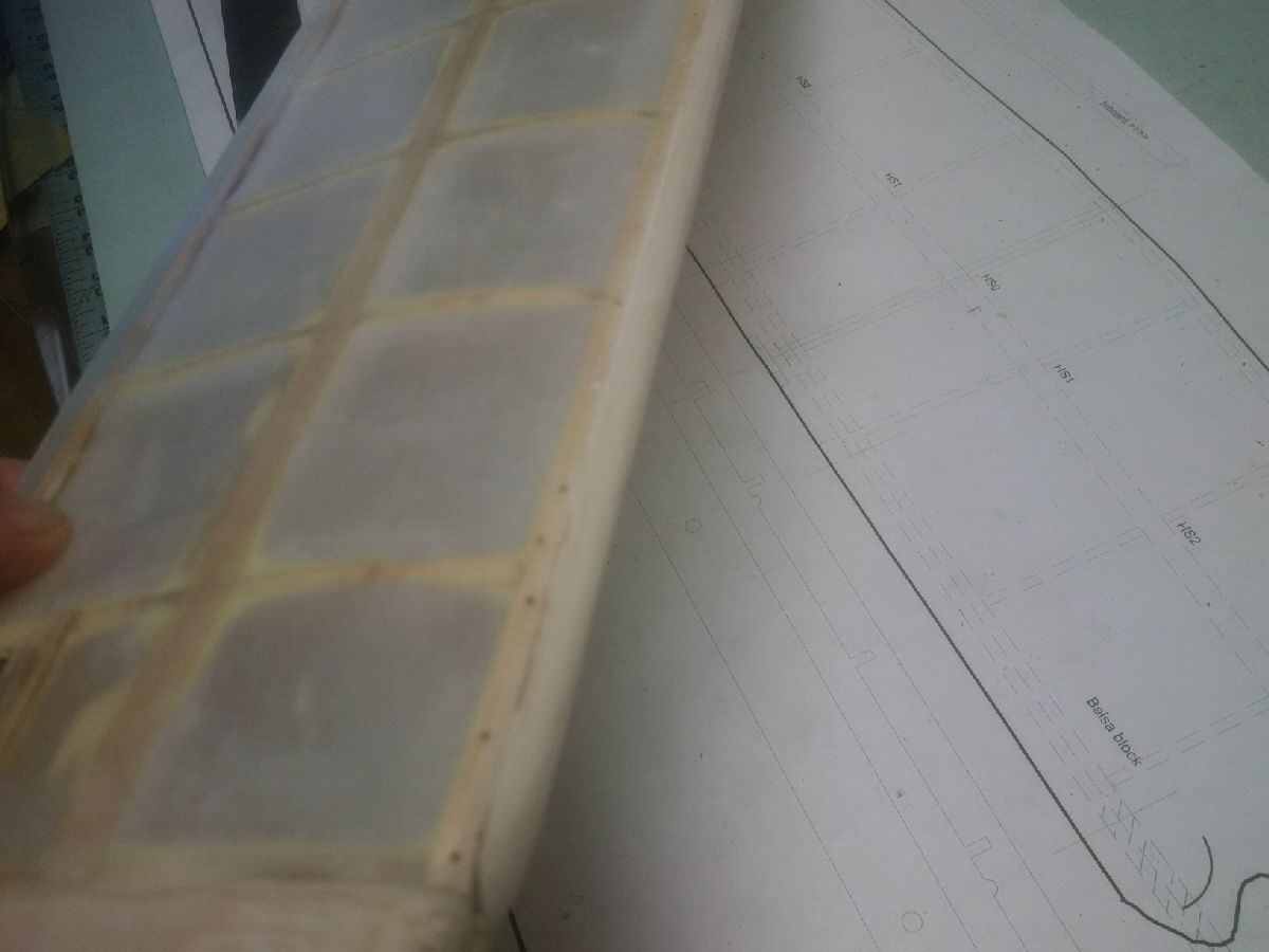

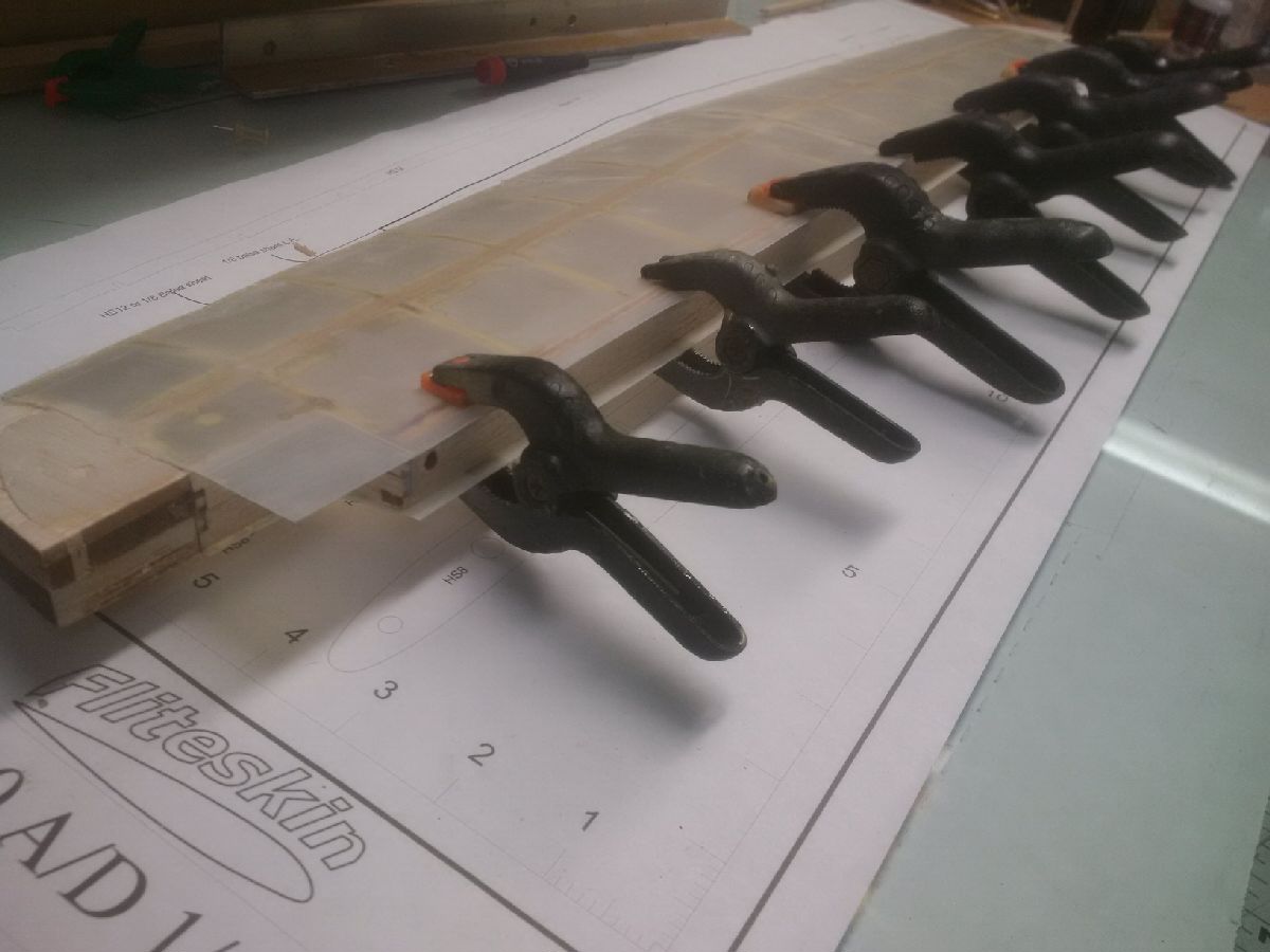

Posted: September/16/2018 at 2:28pm  Quote

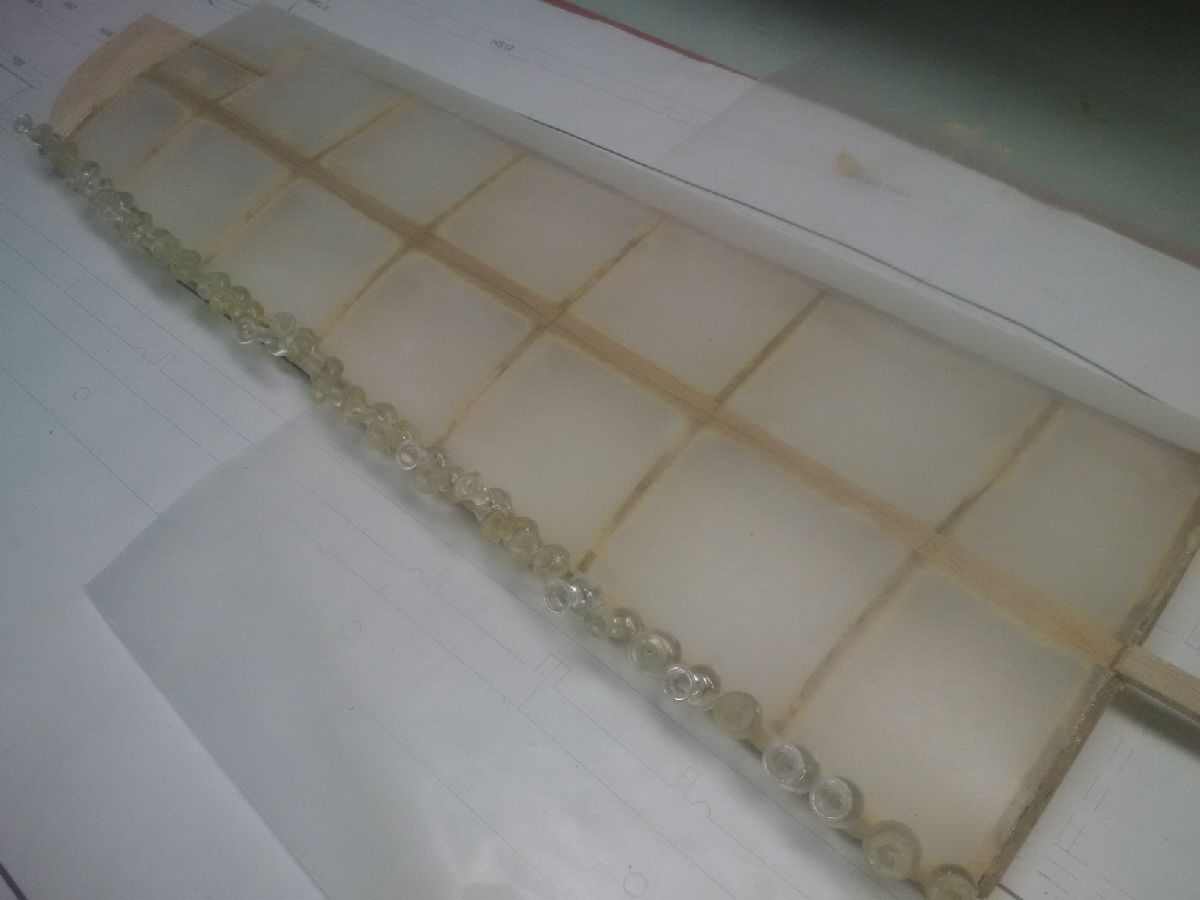

skinning the stab is done is 4 section:

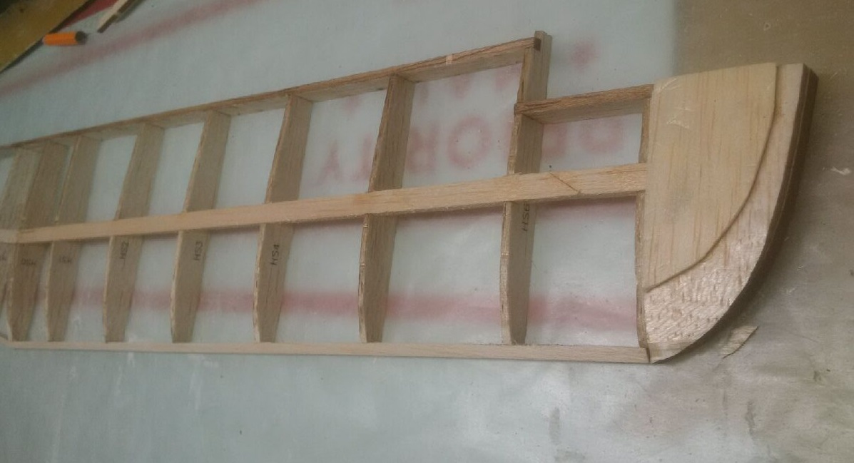

Posted: September/20/2018 at 11:24am  Quote

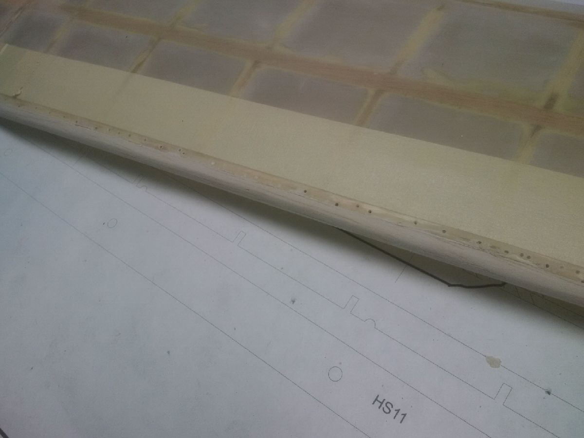

Progress on the Fw190 Stab:\
HS11 goes in after the two halves are joined:

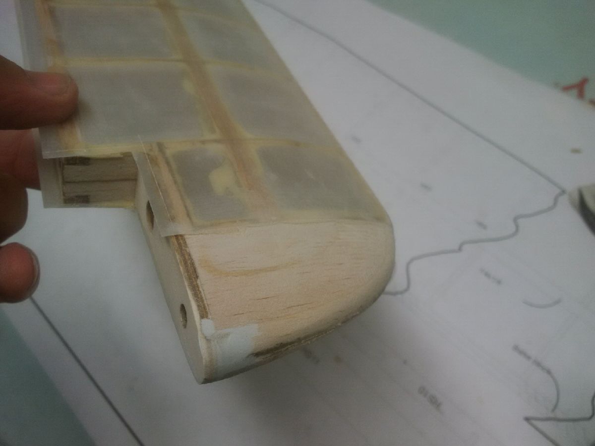

Posted: September/21/2018 at 2:46pm  Quote

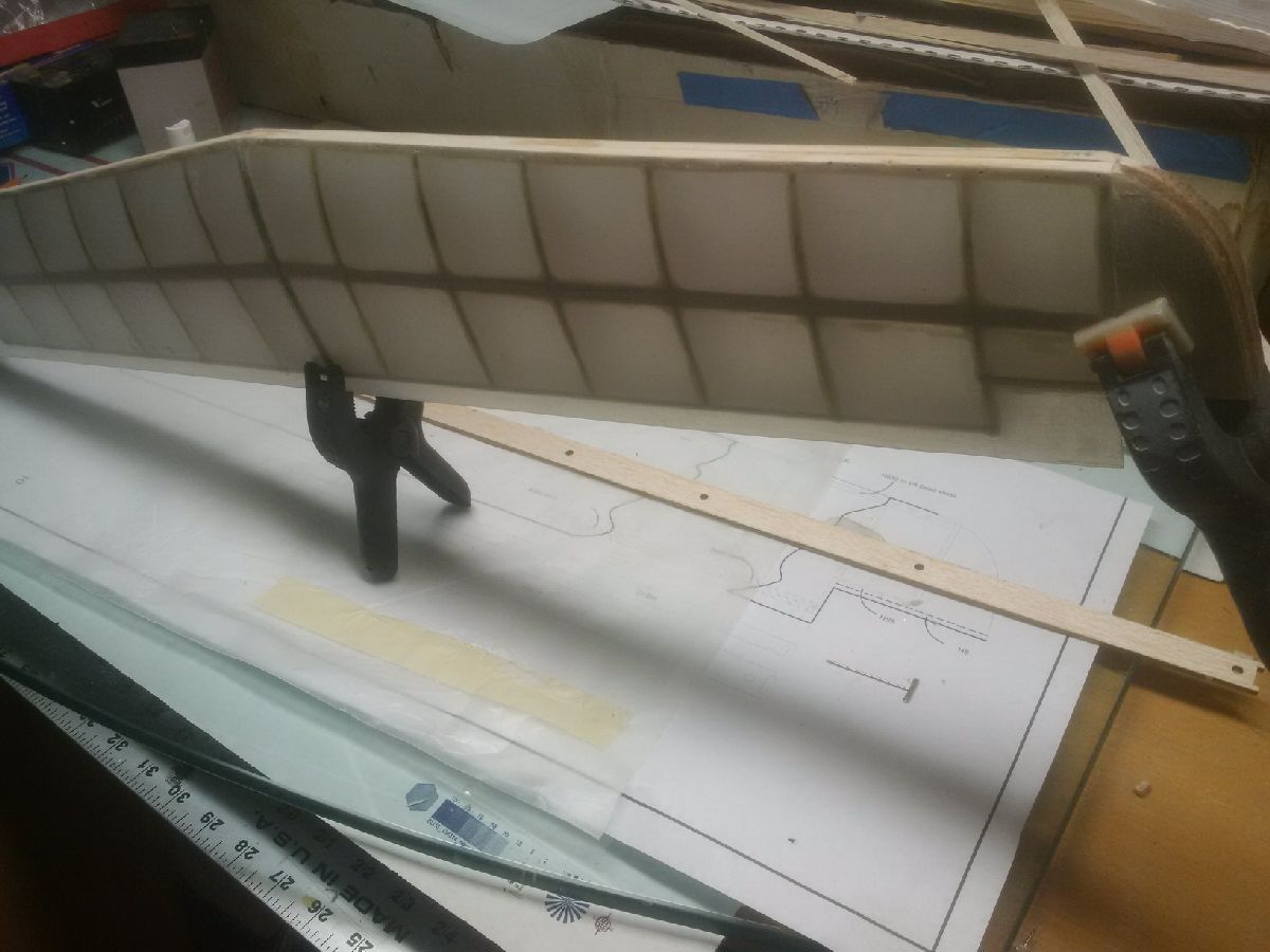

Tip cross section is added first:

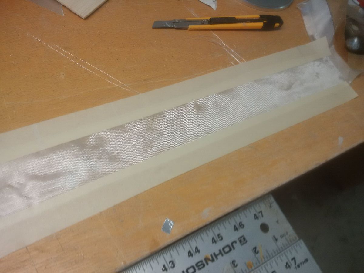

Posted: September/29/2018 at 3:09pm  Quote
Once I sanded the wing tips to shape, I am ready to glass LE and tips:
First step: masking tape off the edge of the LE:
 Cut a strip of thin glass cloth
JG
