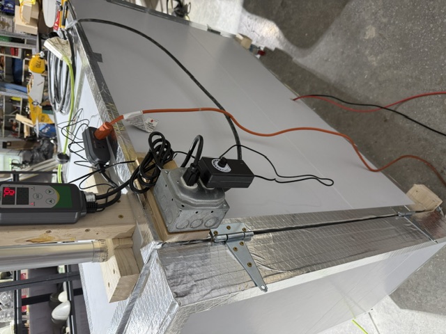

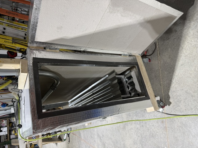

Posted: June/01/2026 at 5:06pm  Quote
I just finished the drying setup today and did a first test to see if everything was working as I expected.  Good news is that the heating systems work well and the heat is well contained.  The air circulation setup is working well also.  So, I may try to do some drying tomorrow as a test.  I will try to do this as I am getting ready to travel to Macs for Georgia Warbirds this weekend.
Here are a couple of pictures for those that might be interested in this very utilitarian item.  Nothing fancy, but it needs to be able to deal with 200F for a sustained period (think 4-6hrs)
I have a little tidying up of wiring yet to do, but didn't want to do that until I tested everything.
