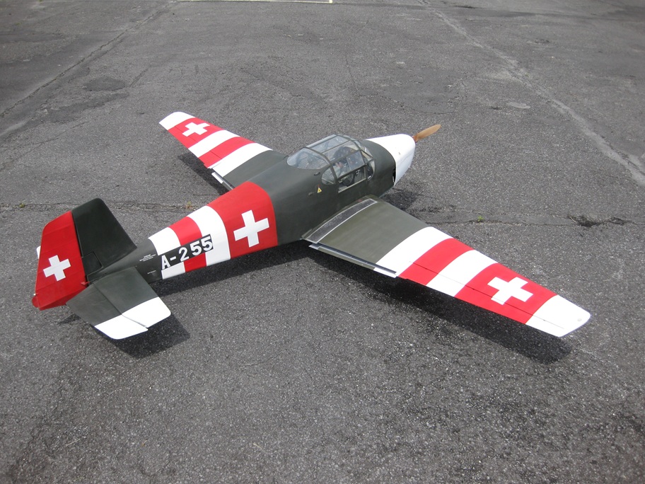

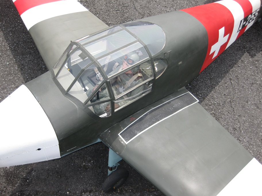

Still deciding what scale to build, either 1/4 or 1/5, but I've continued the research I find the full size uses a NACA 23017 at the root; and a NACA 4412 at the tip, but no information on how much washout.
Looking at this photo I see a pronounced twist at the tip so I will use as a guide.

Washout is your friend! I lost a Fw190 on the first flight to tip stall & it had 2 degrees of washout. The second one has 3 1/2 degrees, it's still alive!
