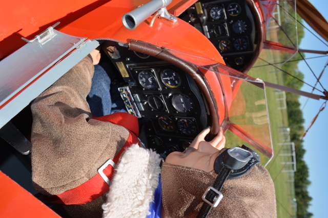

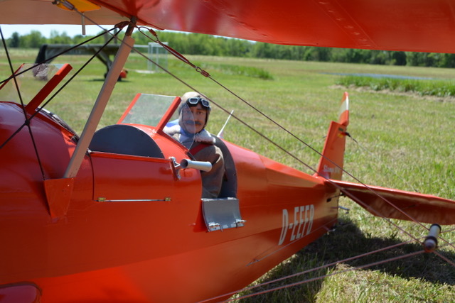

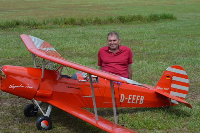

She is 37%. I am using the Schlunndt G62 Belt drive spinning a 34x20 prop. What is super cool is that the reduction actually spins the prop at scale speed, IE full throttle 2700rpm and It idles down to 5-600 rpm.
I covered here with Stits and dope, has ribstitching, tapes a few inspection rings. Paint is dope, about 6 coats, wet sanded, sprayed, wet sanded, sprayed etc. tail number is masked at and sprayed as well as the starburst and tail stripes. I was able to get the pilot from Twin Pilot in Germany, no, he is not my twin.
Dual Futaba RX, Dual Fromeco LiOn, 5200mahs each. I have each receiver controlling one half of the plane. I am using JR Servos all around.
I have a homemade smoke pump powered by an outrunner and a 1200mah 3S.
the instrument panels came from Aerocockpit, and I made some other bits and pieces with the use of a 3d printer.
She weighs 51lbs ready to fly.
