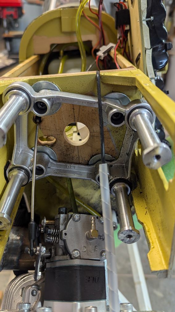

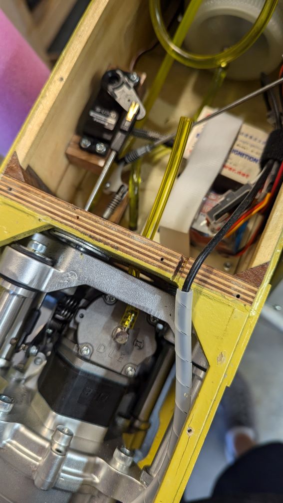

After a few discussions with Steve I decided to make a couple setup modifications to eliminate any doubt that the carb is operating in the best possible conditions.  The DLE carb comes with a hose barb tap for venting off the diaphragm pump, so why not use it.  I attached a short piece of tubing to it, ran it through the firewall an into the body of the fuse where atmospheric pressure should be more normalized.  I also drilled a 1" diameter hole in the firewall directly behind the carb.  There can be a lot of back and forth on the need for this hole but what do I have to loose, so I did it .

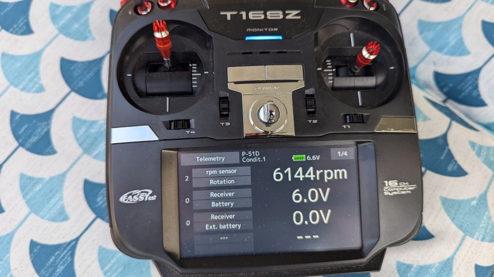

After making these mods, I decided to run the engine again with the cowl removed.  I instantly gained ~200 more RPM and was able to continue to lean the high end out with continued performance gain.  Ultimately getting ~6130 RPM +/- (almost 400 more RPM than before).  This is more like it!  I did have to richen up the low end a little, not unexpected with cranking down the high end.
Now it's interesting that when I put the cowl on the day before that the low end became lean and the high end became rich.  Making this firewall and vent mod basically did the same thing with the cowl off.  So, I'm hoping that with the cowl on I don't loose anything but maybe gain?  Will have to wait and see as it was getting dark and I didn't want to mess with it anymore.

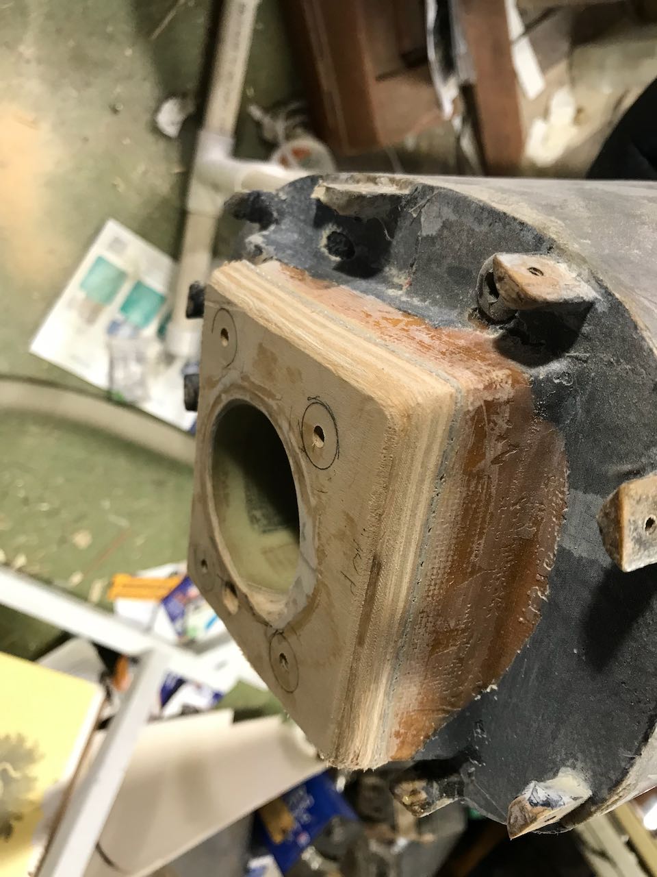

Hole in firewall for the carb intake.
Vent tube

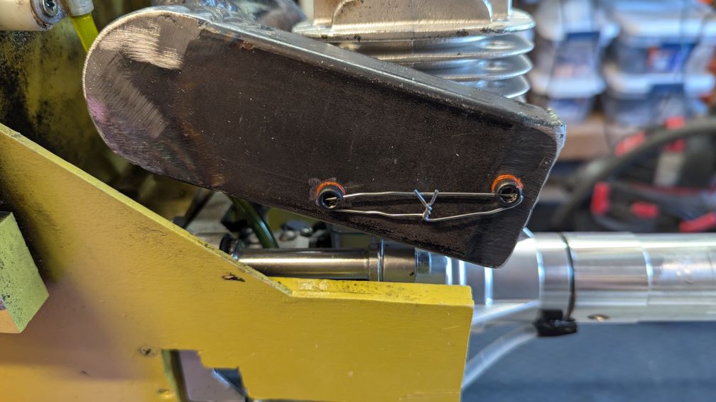

Wanted to document this...paperclip through the bolt heads.  They are not going to turn out.

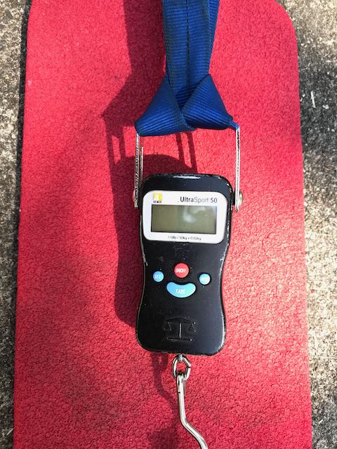

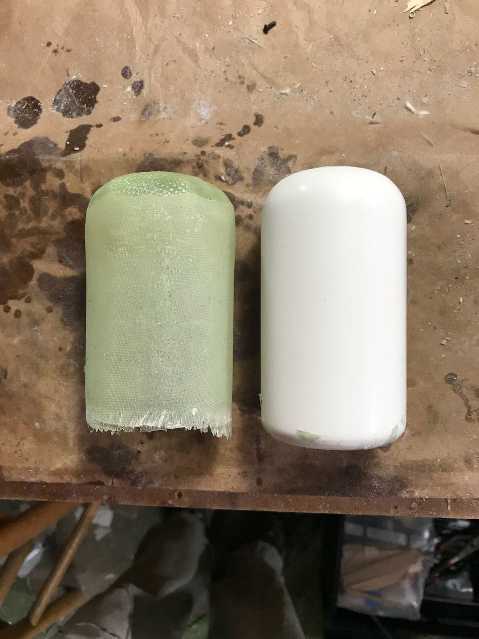

I never felt good about having the carb right up against the firewall so I make a cup of fiberglass molded around a plastic bottle then put the cup in the firewall.

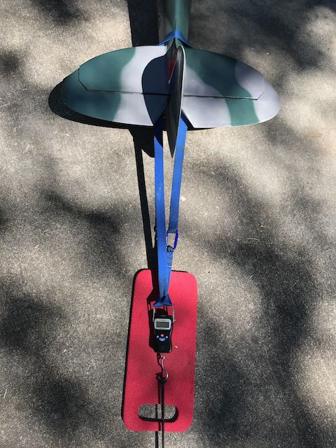

I would try several props, measure the static thrust with my ever so primitive static thrust test rig and use the one that made the most static thrust.
The two bolts on the upper left is what the safety wire on the two muffler allen screws should look like.
Safety Wire

I opted for a taught paperclip instead of wiring the screws as you show.  I figured as stiff as a paperclip is, if I made it tight so it could not create slack that the screws could not back out.  As a bonus, it is easy to remove and reuse.

Yes, I did figure it out and now all is good in RPM land!  I took the cowl off and went back through my carb adjustment process and now I'm getting ~6300 RPM +/- with a constant hold above 6200RPM.  Throttle transition is instant and idle is smooth as silk.  I didn't get to put the cowl back on and give that a go as thunderstorms were rolling in, but for now I am very happy with the results of my muffler and other mods.
