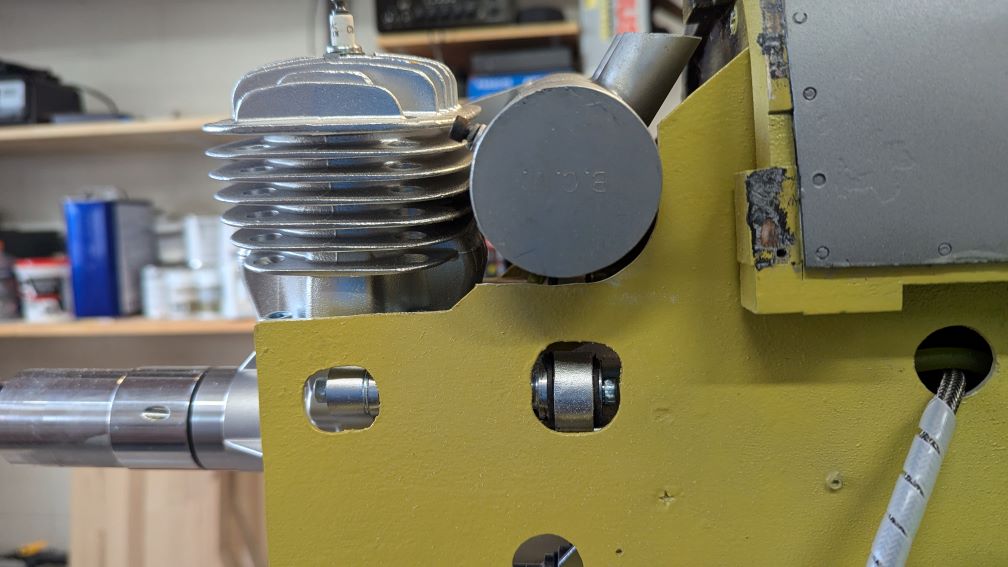

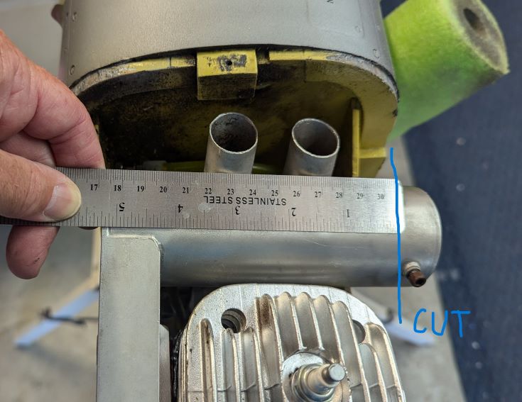

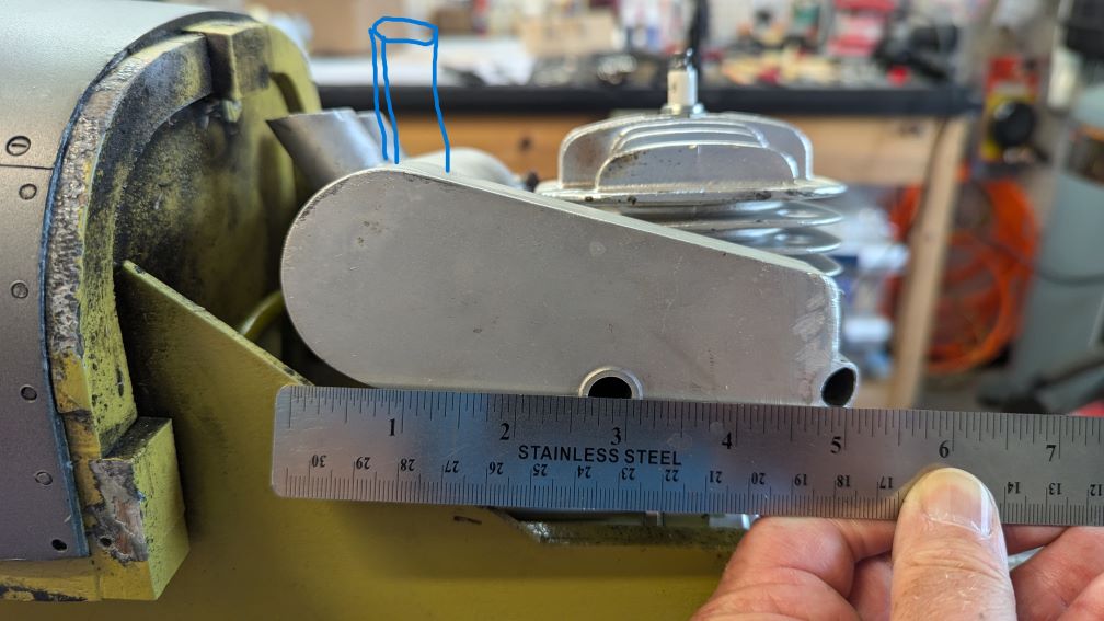

2 - in order to keep the engine and muffler inside the cowling I purchased a B&B muffler for the DLE-85.  This muffler was restricting the engine and I was not getting enough RPM's.  I'm not even sure why B&B even sells this muffler for this engine.  I have a Bisson muffler for another DLE-85 Z P-40 that I am building so I decided to mount it to the P-51 to see if it would fit.  It actually fits except for the can is too long on one side.  With lead times being what they are for RC nowadays, I have decided to build my own muffler and have a friend of mine weld it up for me.  Below I am going to start documenting that muffler build and progress to getting the bird back in the air.
For now the P-51 is grounded until I can get engine performance (SPEED! )
In these photos you can see the muffler fits but needs some modification to fit within the cowling and deflect exhaust properly.

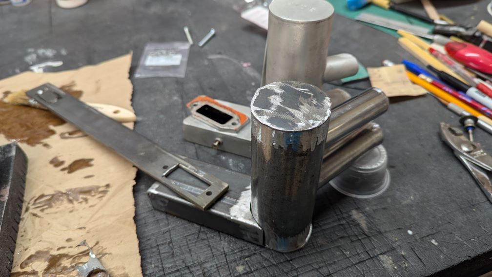

In case I were the one doing the welding, I went with a light gauge steel.  Luckily I know a guy who does repair welding for a living and he is going to weld it for me.

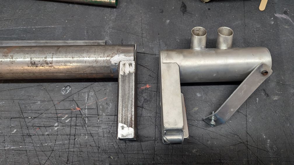

Using the Bisson muffler as a guide, and the modifications I need to make, I almost have the new muffler parted out.
There is going to be a weight difference here so after I get this muffler mounted and I'm satisfied I can get max engine performance, I will have to rebalance the plane.
