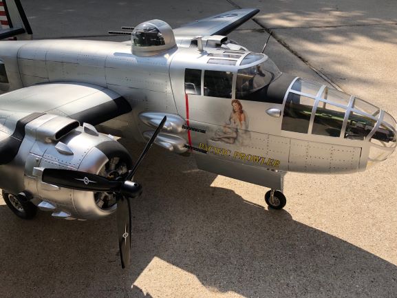

Thanks for saying hello. sorry to hear about the B-25. I actually still have mine. However, full disclosure, I think I ripped out my gear last time I flew it (sometime last year). It flies great. Very scale and has tons of power with the scorpion motors. However, I always have to grease the landing as it is pretty heavy. Again though, it is pretty scale, it isn’t a floater and it is not meant to be.

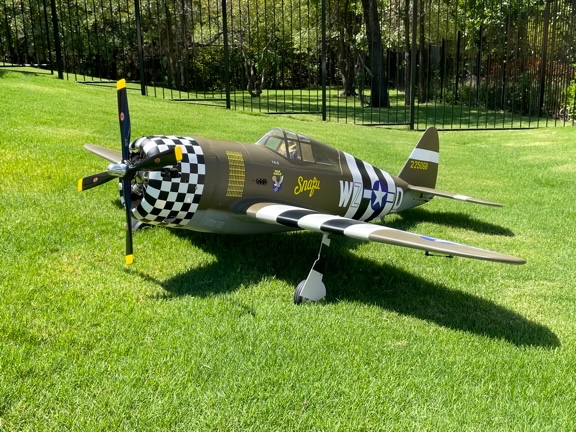

I fly in the Dallas Fort Worth area. I am a member of the Grapevine club which is very central, right near DFW airport. Speaking of the P47. It is no more. It was a beauty but physics (or more accurately, fluid dynamics) got in the way. I powered it with a UMS125 5 cylinder radial. It took off great and I was able to fly around 3 or 4 laps with no problem. Then on the downwind leg, just before the turn to base, I cut back on the power and it went dead stick! It dropped like a 35 lbs rock and crashed in the trees. I just had no altitude. The post mortem with Andrian from CH Ignitions was that I misunderstood the directions. For this engine you are advised to chuck the cheap Chinese pump. It is “not needed”. HOWEVER, I thought this meant I could forego a fuel pump altogether….WRONG! I needed an expensive German APS pump.
The funny thing is when Adrian explained it, it made total sense. The engine uses a Walbro carb just like my 2 cycle engines. This means that it relies on the crankcase to provide pulse pressure to drive the pumping action of the carb. Adrian pointed out that in a 5 cylinder engine you have cylinders moving up and down at the same time so the resultant pressure is LOWER or weaker than you we typically see in like a DA engine. This is why the engine needs the fuel pump to boost the pump pressure. Logical….after the fact. Lesson learned. This is why I love this hobby. (Can you tell that I am an engineer…or was?)

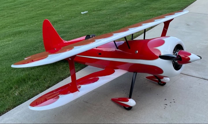

Anyways, one door closes, another opens. After licking my wounds for a year I just finished putting the radial into an 85 inch Extreme Flight Muscle Bipe. Beautiful plane that runs great with this engine. Is it overkill…definitely…but the sound is so cool.
Here are some pics and a link to my maiden flight….
