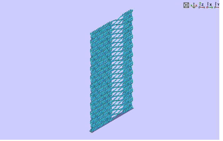

Actually its not that difficult, nor expensive to achieve with all the readily available resources; people and an .stl file.
ABS, PLA printers capable of achieving good results are down to $200 for 4 c.i. to 5.5 c.i. X,Y,Z print volume.
Thanks to Darrin He saved me lots of time & compromise to achieve a wicker matrix the difficult part of the seat.
I now arrange parts appropriately and add a header to back, arms, and legs from a chair w/o the back.  Header and legs
are bonded together to form the wicker seat. A "leather" cover goes over top of back and down front forming the cushion.
These parts go to form a facade of what the seats look like. Will probably use RTV mold and Alumilite to save time since
I need 12 of these.

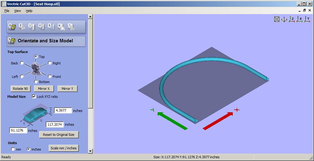

The software to edit files for milling or printing is not expensive. This is Vectric's Cut3D. I use it as an editor to size .stl to
the desired scale for printing. Printers have their own print software. To make a part you send to printer, test a portion of
the part to be sure everything is as desired...adjust speed and temp...turn it loose to print the part.
Thanks again Darrin
