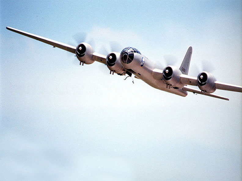

PS: I'm moving (motorhome) up to Mac tomorrow to start rebuilding the B-29, John and Mac figures a week (24/7) to get the structure back together and then Mac will reinstall everything that not hurt, which looks pretty good so far, all the wires ect in fuselage will be replaced.

Good on you Charlie.  Hope to see the B-29 back up soon.
