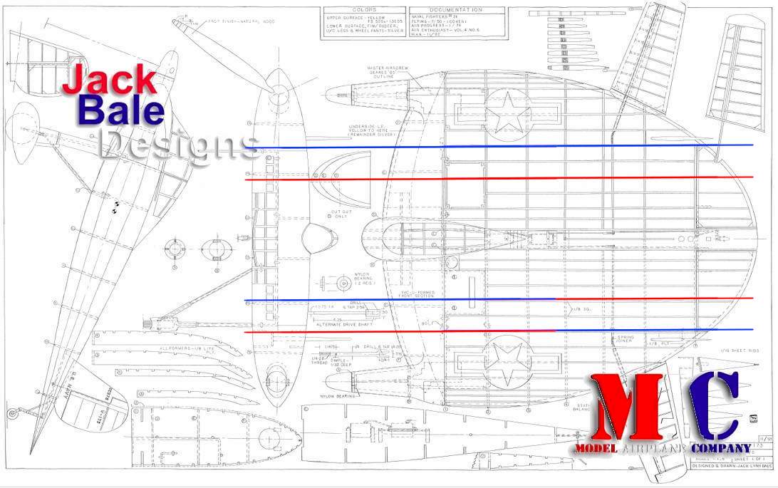

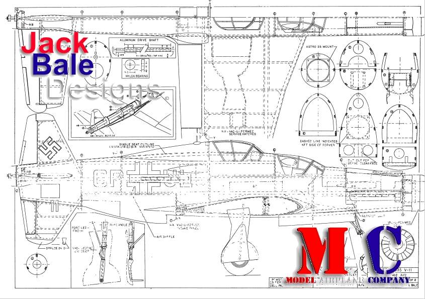

<br><br>Thomas,<br><br>I seriously doubt there's going to be many more than one built... I gave the plans to Josh last night. He wants it at 80".<br>Just a wee bit torqueeeeeeeee.
LoL. An 80” V173 is a big model. I looked at enlarging mine to that size and its about the size of an original minicooper and 3 1/2 feet tall.
It was unrealistic Imo to pursue one that size.
Thomas W.

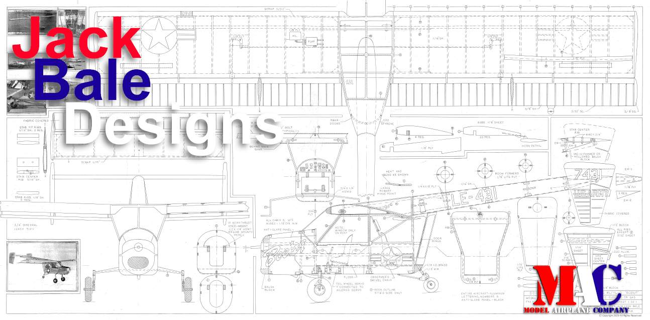

Thomas,
We will offer the original "diameter" and another of a yet to be determined enlargement split to a three piece to permit portability.
I show an "example" of possible split along blue and red lines.
Landing gear strut would probably be a sleeved slip tolerance two piece. Prop thrust extentions/fuse "leading edge front" would probably
be a three piece vacuum formed shroud.

Posted: June/07/2023 at 8:46am  Quote
"Josh is more or less on his own relative to his desire for an 80" overall width."
To all who think that 80" span is "Unrealistic", please bear in mind that this measured across the tips of the tailerons. If one were to measure across the "Pancake" - it will probably be 60" or less. Ed: can you look into this please?
Also, I would split the fuselage along the blue lines.
Since this will be a "Scratch Builders Delight" I would leave the engine extensions and LE to the builder. Perhaps just vaccuform the canopy and bottom windows.
Just my 2C

Posts: 9658
Posted: June/07/2023 at 9:03am  Quote
Tim,
This is "probably" going to be available in its original drawing planform. Neither Sam nor I have reviewed
the plan for dropouts and tolerable enlargement possibility. This is an excellent example of why our plan
list follows the line of practicality and realistic possibility at a reasonable development and final price.
There are multiple RCSB scratch builders who have designed a Do-335 with success in different sizes.

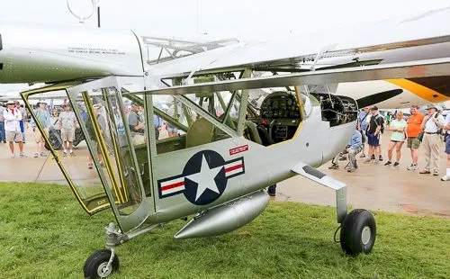

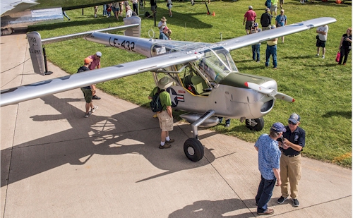

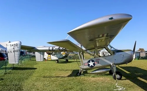

.......Boeing XL-YL-15 "Scout"
...Remember to click Boeing YL-15 "Scout" plan to vote for your preference of plans/kits listed in the Jack Lynn Bale plans poll. MAC's YL-15 kit includes a 66
...photo documentation walk-around with multiple three and four view drawings.

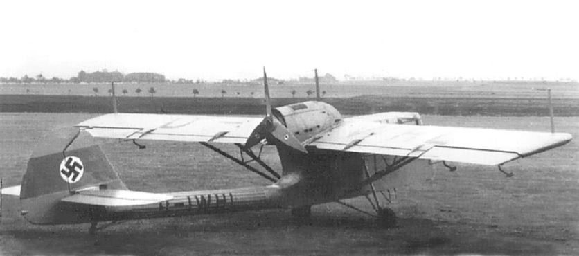

...........Siebel_Si-201_V2
Boeing had its YL-15 and Siebel had its Si-201 V2. Part of the swept wing evolution in Germany. Clk pic to vote for your preference in our kit poll.
The Reichsluftfahrtministerium (RLM) was Germany's Nazi aviation department from 1933–1945. RLM issued RFP specs to Gernan aircraft manufacturers to enter into competition to develop designs for specific missions. The Siebel Si-201 V2 lost out in RLM competition against the Fieseler F-156 Storch for a short takeoff & landing utility-reconnaissance aircraft.
