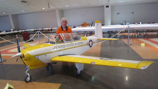

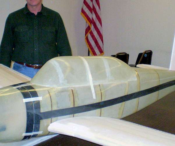

There are two components to the canopy...1. clear and 2. the opaque fiberglass frame.

Ziroli has the plug to pull the clear canopy. Mark's son has the canopy frame and "possibly" another plug for the PETG. If this is pulled in normal fashion (one piece) you could buy two of the clear PETG and use one as the base for the frame. This works "if" the clear canopy is a shoe fit to another.
Bob should be able to answer that. Most pic of the model have shown an articulated sliding canopy. Obviously the best answer is the clear canopy does not have a defined frame line so "stacking" would more easily be achieved.
If the fiberglass canopy frame does not come pre-cut...this is the best of all worlds as it can be converted to a vacuum form plug for both the frame and the PETG.

Ed, you are correct, the "glass" canopy frame does not come with the window openings pre-cut.
It is glued over the clear canopy after the 'windows" are cut from the frame. The Glass frame has distinct
panels with a change in height where the movable frame slides over the adjacent panel.  Unfortunately the steps are not visible in the above photo.
The clear canopy has smoother transitions between panels.
