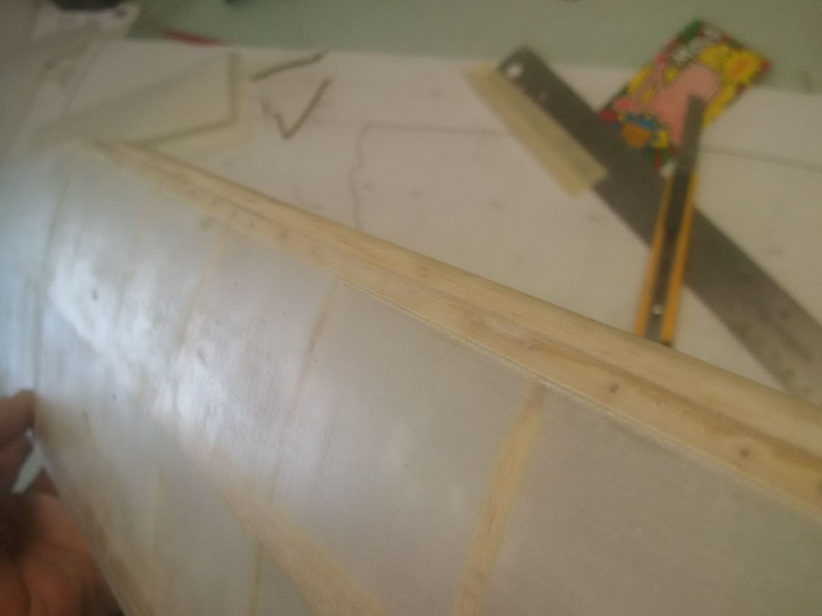

What type of glue did you use to attach the fliteskin to the bare wood?
the expansive type \

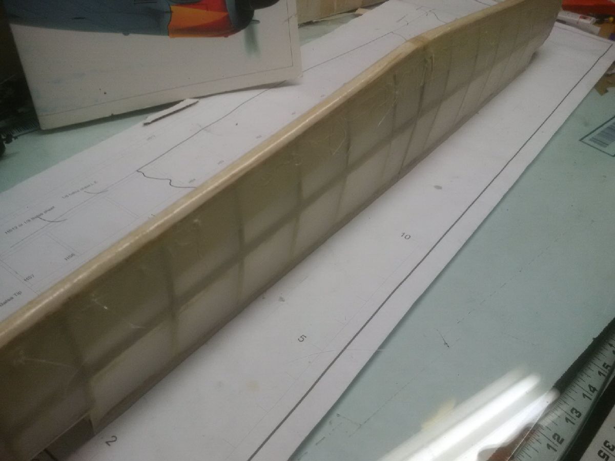

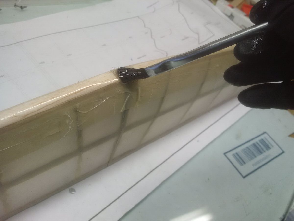

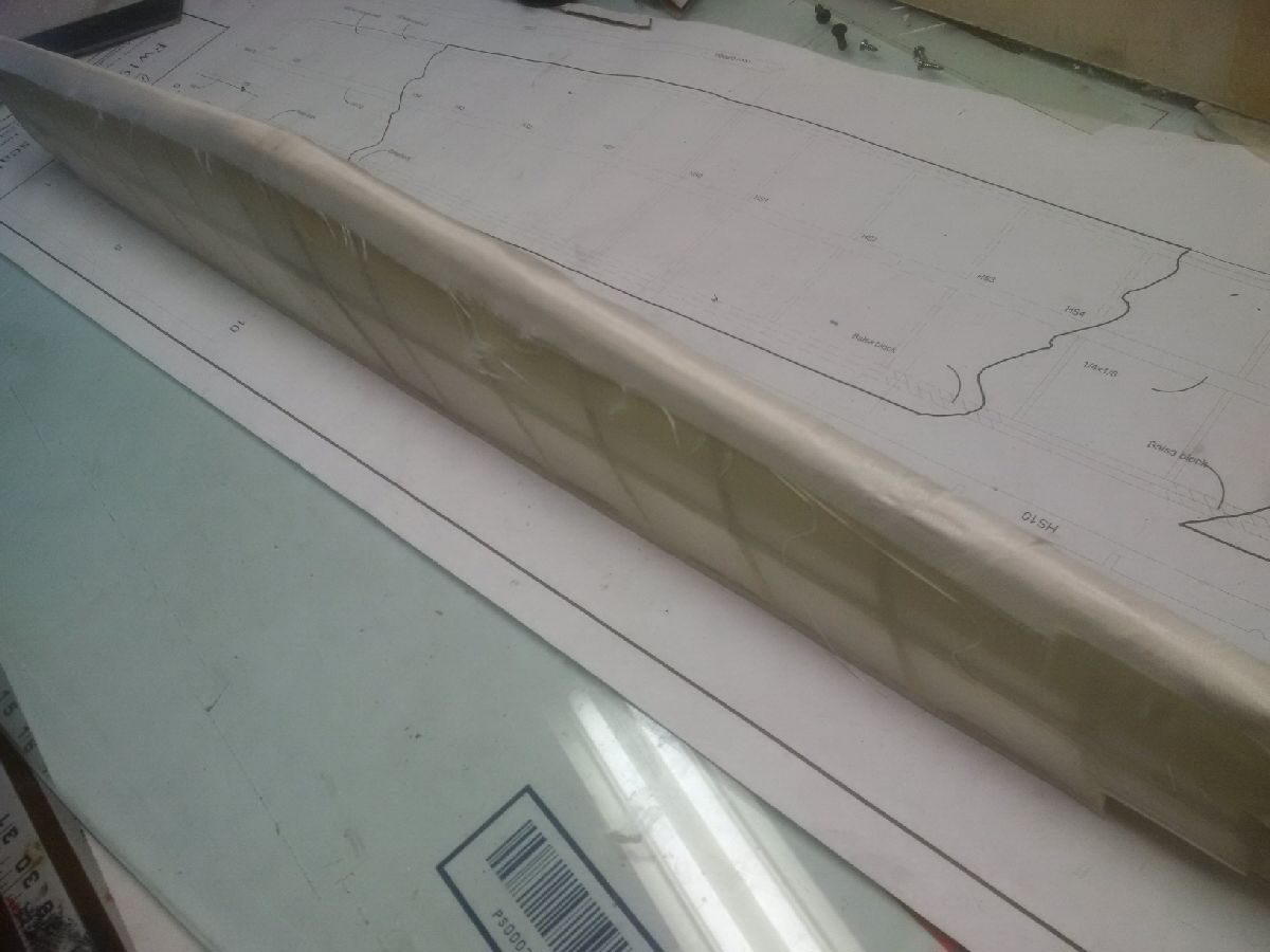

I hope this pictures will dispel the mystery of the transition from fliteskin sheeting to the wood frame, etc.
Once the strip of glass cloth is positioned in place ( I sometimes tape it or tack it with 3M super 77) I soak it with finishing resin
I don't need to worry about going too far because the tape previously put in place will mark the exact edge of the LE.
Now, wait until it sets, if needed I may brush a second coat before I do the tips.

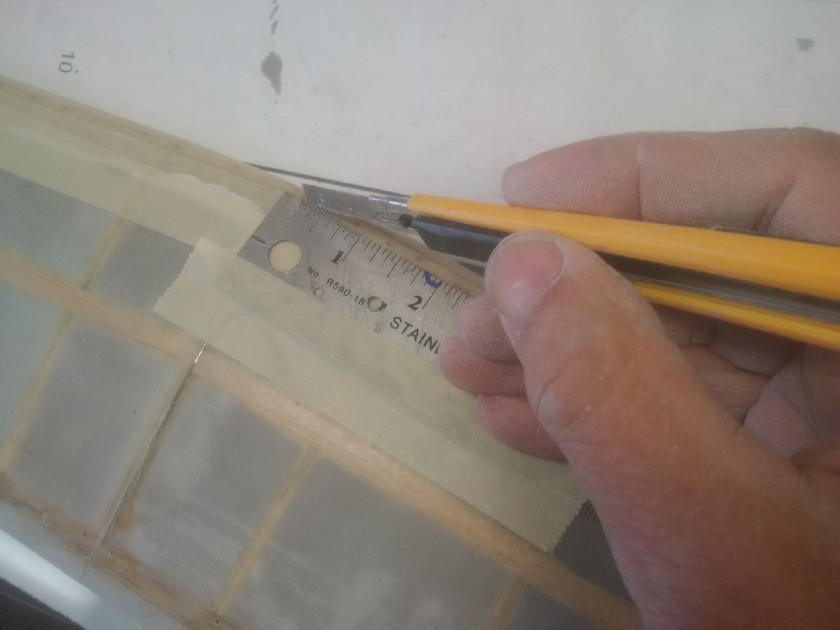

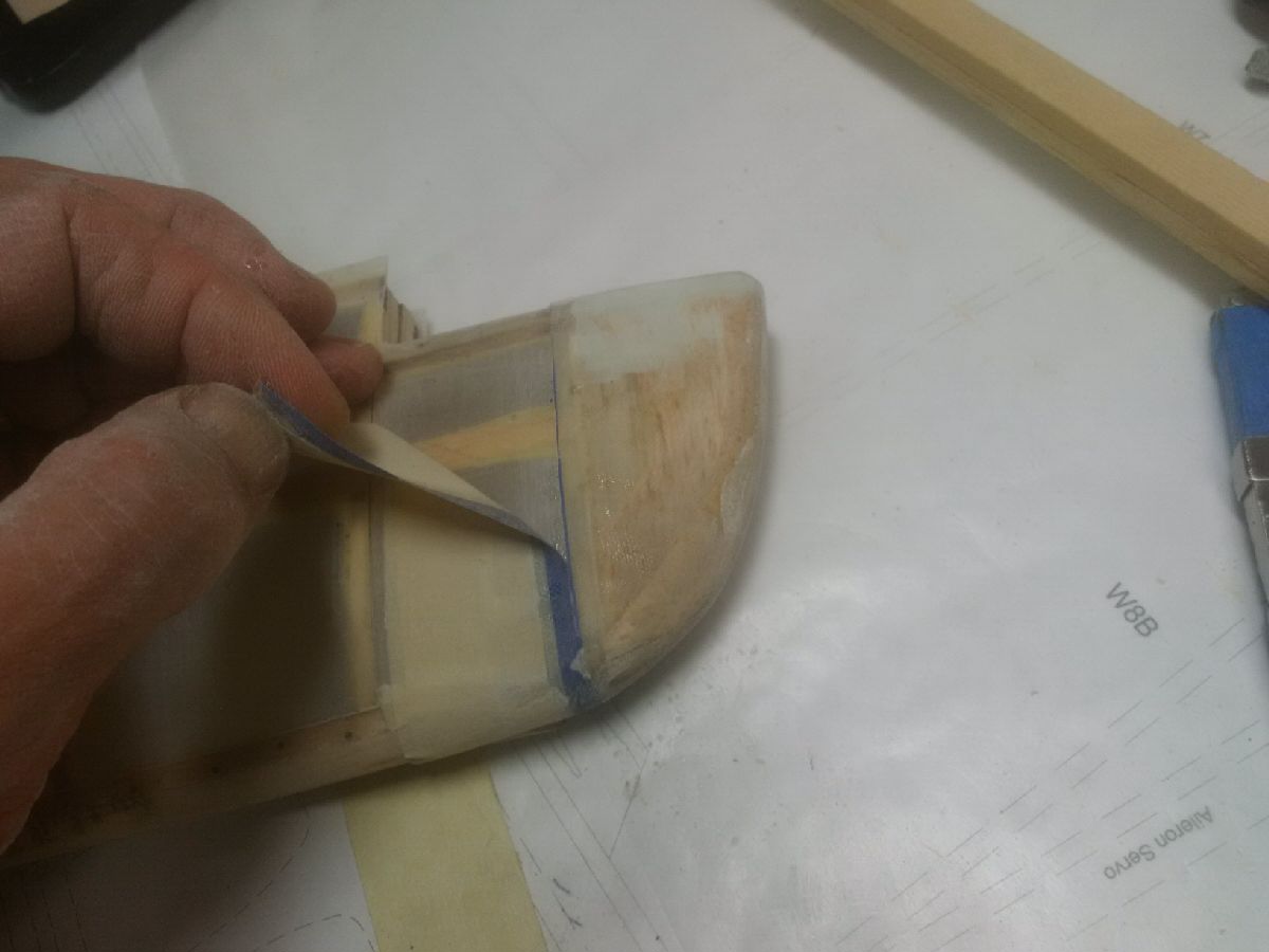

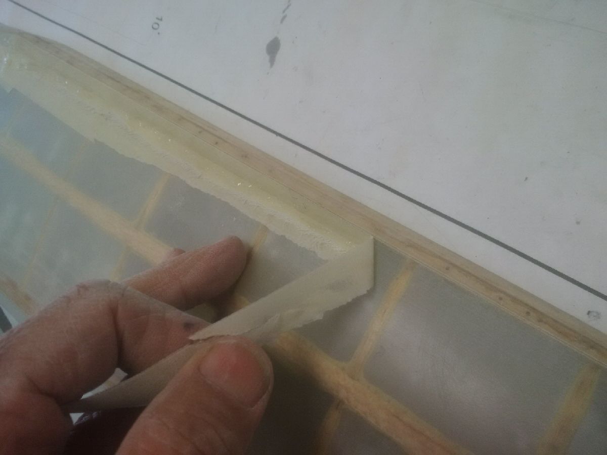

Before pulling the tape, I sand the LE smooth and run a sharp blade at the edge of the LE:
Then I pull the tape, revealing a sharp LE

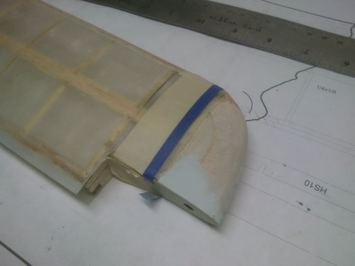

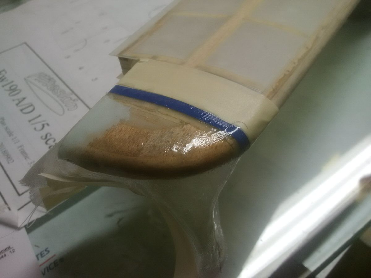

In In order to glass the wing or stab tips I need to mark off the edges with tape after some wood filling.
The tips seem to be the hardest part to fiberglass and I can't do both sides at the same time, so I start with the bottom side first

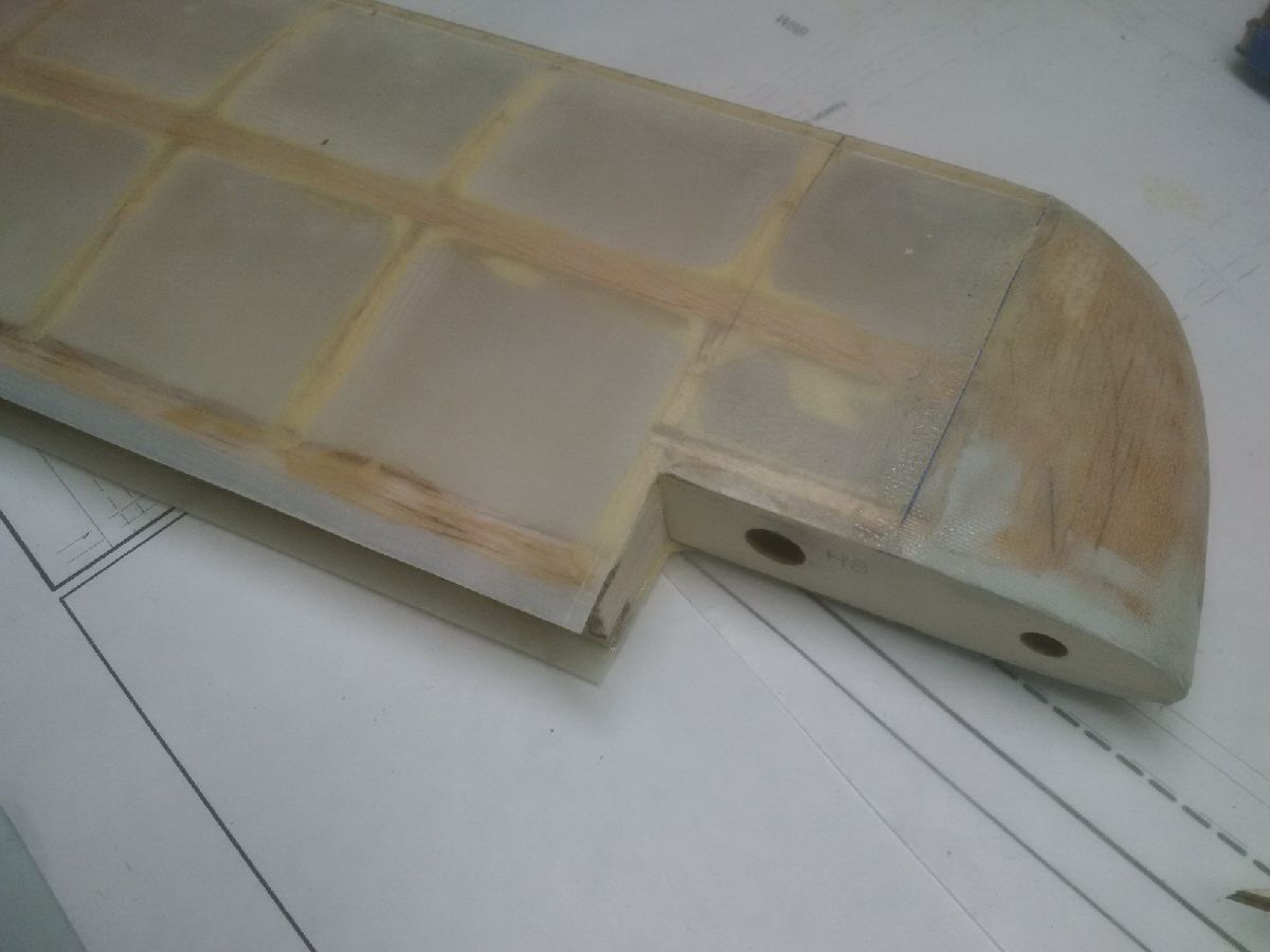

And here is the tip finished after a bit of sanding:
Wing is next!

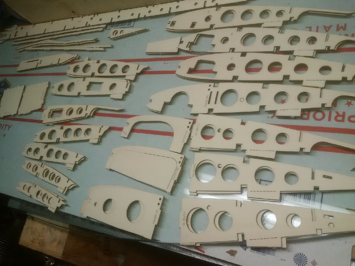

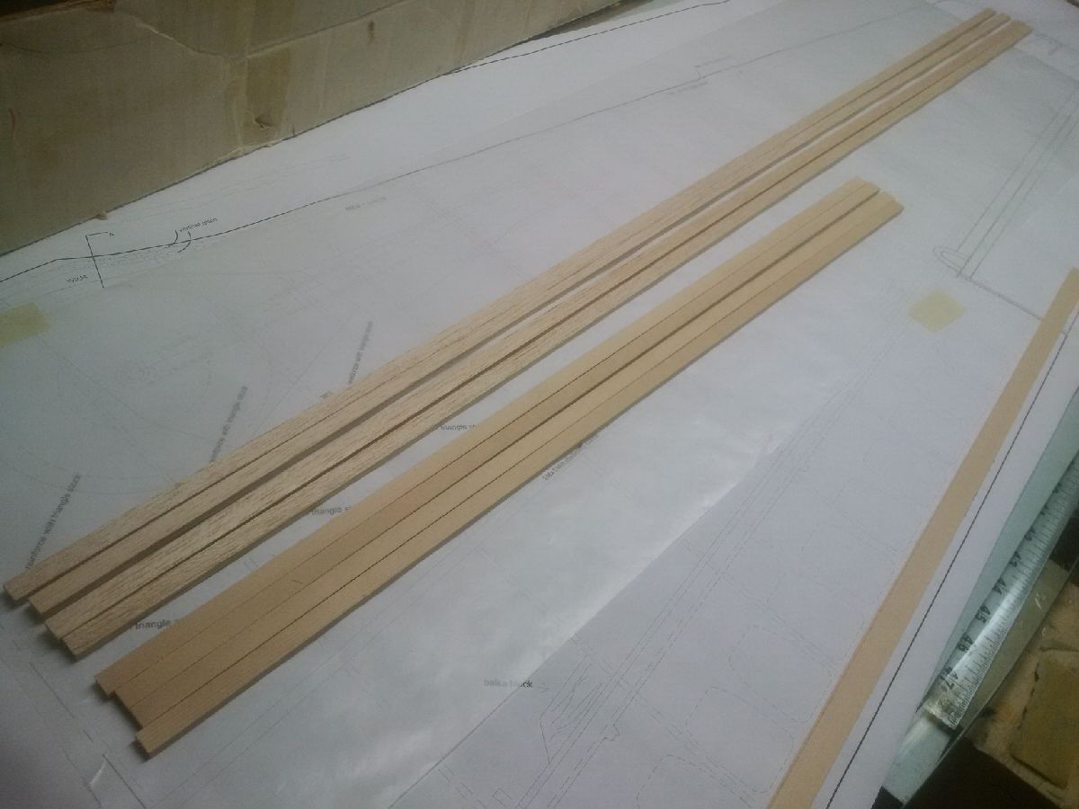

I start taking inventory of the ribs and doublers for the wing:
Stock wood for the spar lamination:
